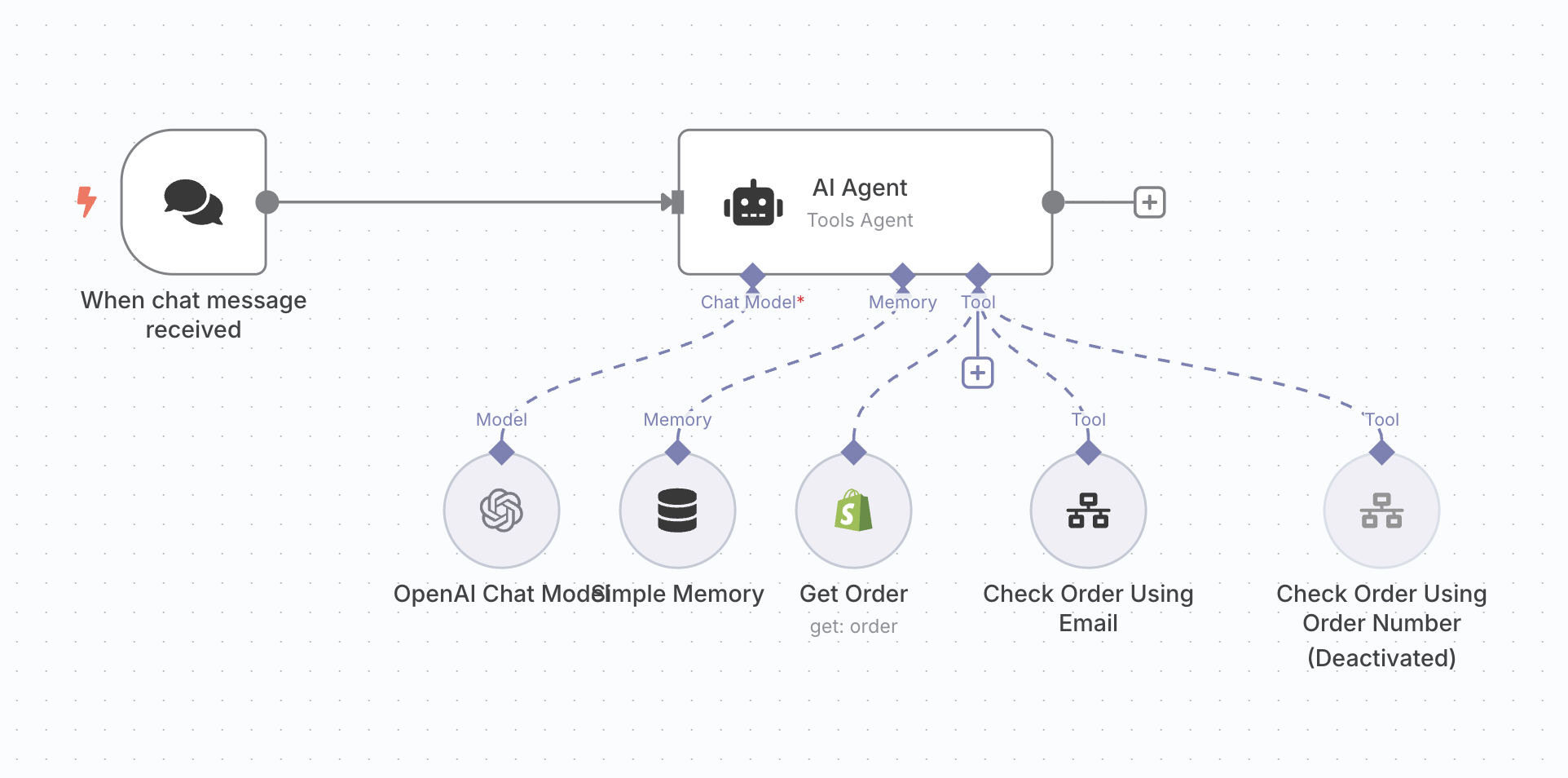

I have this workflow:

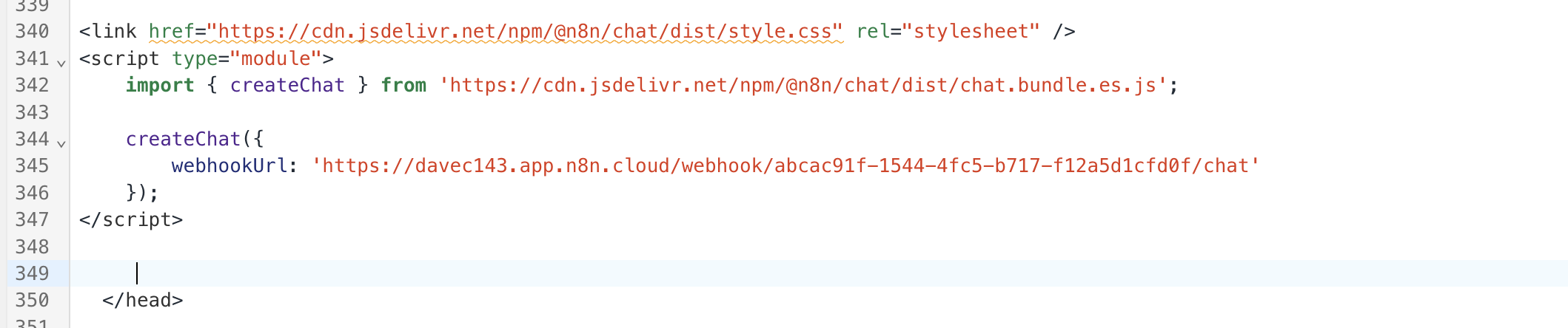

Thank you for the response! I just added it in the theme.liquid’s header section:

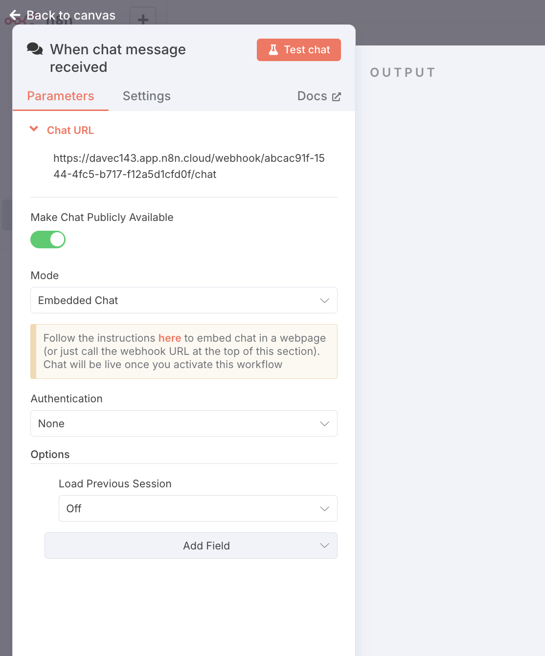

I can guess your turn on the loadPreviousSession setting.
But seems can not look the actual error message.
I test my end it didn’t show the error message.
Can you confirm you chat trigger setting?
Originally, the settings for loadPreviousSession was not there, then I added it. But it still kept running even after adding this setting.
What’s the rest of the code in your website.
It seems issue might be in how Chat is being added to your page.
P.S, I believe you should not share your webhookUrl without blurring it. Others can use it, and they could abuse that.
