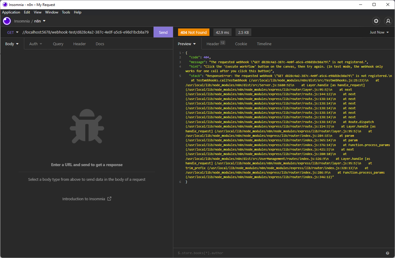

This is a screenshot from the browser page. There is only 404 nothing else.
So this error suggests the problem lives outside of your n8n instance. n8n would typically respond with a JSON-formatted error message like this:
Can you confirm how you have deployed n8n? Is it running behind a proxy server?
