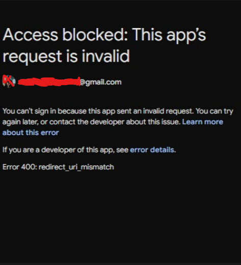

Access Blocked: This app's request is invalid - error 400: redirect_uri_mismatch
I’m having this issue with my N8N workflow, I’m not able to login or add any credential related to oauth.
Every node I use I get the same error, I’m using n8n cloud not self hosting… I created a new trial account and everything worked perfectly.
Could it be an issue with my accounts URI? If so how can I fix it because It doesn’t seem I can get the URI when I’m using n8n cloud.

Thing is i’m using n8n cloud so I can’t see the URI its done by default on the n8n cloud, When i did a new trial account all I did is press sign in and it worked normally so probably this account’s redirect is old and there is no way for me to check it or fix it since again its on the n8n cloud

Hey, I’ve tried this and even tried to publish it but its still blocked even after 24hours
The issue isn’t only on google cloud console, Its on every node login that requires Oauth, I tried slack I got the same issue I tried github I got the same issue etc…
they all give me the same error

Hey, The solution was to just keep the N8N version to latest stable.
It looks like n8n doesn’t update automatically so always have to check for new updates.
Updating it fixed the issue.
