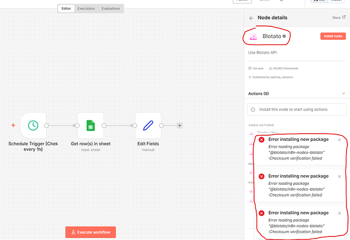

Please help me resolve this problem. I’m a beginner and would appreciate step-by-step instructions. Thank you.
Here is the problem I’m facing
I can’t install the Blotato node in n8n. When I click “Install,” I keep getting the error message below. Please note that I haven’t installed n8n locally on my machine; I’m using n8n on Hostinger
Error Message
Error installing new package
Error loading package “@blotato/n8n-nodes-blotato” :Checksum verification failed
In my selfhosted v1.123.6 and on my cloud v2.3.4 I was able to install the community node with no issues. I’d recommend to perform an upgrade first and if that does not help, share some more information on how you’ve setup your instance with hostinger.
