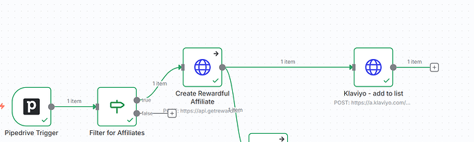

I am building an automation where upon registration via a formular a person gets their profile created in rewardful and after that I want them to get signed up into a Klaviyo list.

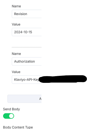

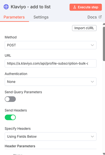

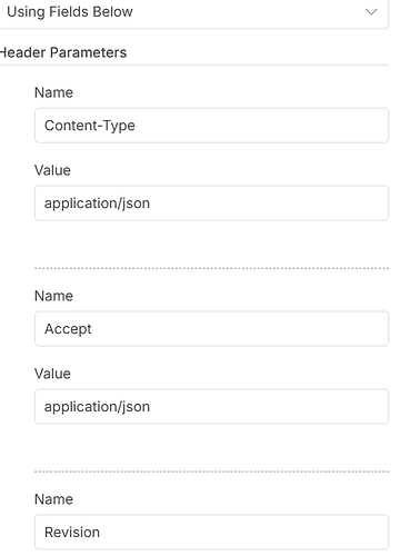

I worked on this using ChatGPT for some time (I am not a developer btw), also have been trying with the API endpoint add profiles to list described in the convo here (I get the error message that list does not exist) and finally have the following setup:

There is now no error message anymore, the node is said to be operated successfully, but still there are no emails added to the list.

3. Headers (Critical!):
You need to add these headers:
  • Authorization: Klaviyo-API-Key YOUR_PRIVATE_API_KEY
  • Content-Type: application/json
  • revision: 2024-10-15 (or latest Klaviyo API version)

  1. Missing Authorization Header: Your screenshot shows “Authentication: None” which won’t work. Klaviyo requires API key authentication.
  2. Wrong Endpoint: The bulk-create-job endpoint creates an asynchronous job that you need to poll for status. It doesn’t immediately add profiles.

The output [{}] means the request succeeded but returned empty data, which typically happens when:
  • The job was created but you’re not checking its status
  • OR the authentication failed silently
Let me know which approach you’d like to use and I can provide more specific setup instructions!
