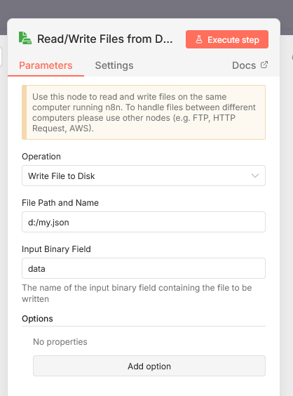

I have a “Read/Write Files from Disk” node. The data comes in from a “Convert to JSON” node and is written well. But now I want to input additionally the filename for the file to save - and if I connect the source node for the filename also with the input of the Write node, neither the data nor the filename is recognized in the node. How do I set the filename and the data correctly in the Write node?

Oh yeah no this wont work. Rather move the Filename node to be inline with other nodes. Something like below. Then in the Read/Write node, you can reference the filename from the Filename node by referencing the name like `$(‘Filename‘).first().json.filename`
Thank you. That worked :slight_smile:
