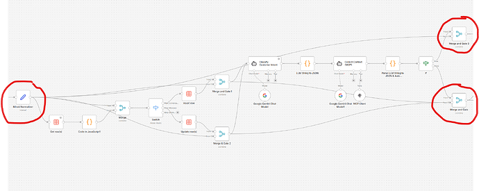

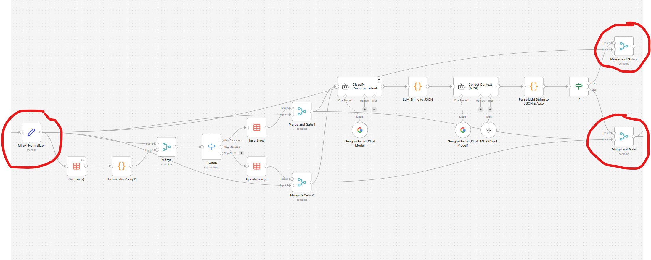

I hope this visualizes the problem. The red circled node on the left is a Set Node that defines all field I need (incl. ID of the conversation with the customer). On the right the enhancement of the information from the set node with the additional fields from the Agent nodes via merge on Conversation ID.. The lineage is broken prior to the set node through a filter..
This is a really common pain point when building agentic workflows in production. I hit the same issue building a multi-platform customer service chatbot.
The pattern I use: “Context Envelope” via Set node before each Agent
Before each Agent node, use a Set node to wrap/preserve the original fields:
// Set node - add these fields:
original_conversation_id: {{ $json.conversation_id }}
original_metadata: {{ $json.metadata }}
original_platform: {{ $json.platform }}
// ... any fields you need downstream
Then after the Agent node output, use another Set node to merge:
conversation_id: {{ $('Set - Preserve Context').item.json.original_conversation_id }}
llm_output: {{ $json.output }}
metadata: {{ $('Set - Preserve Context').item.json.original_metadata }}
This works because $('NodeName').item still references the paired input item even through Agent nodes - as long as you’re processing one item at a time (which is usually the case with Loop Over Items).
For filtering (Problem 1): Instead of filtering items out, use an IF node but keep both branches alive. On the “no response needed” branch, just use a No-op (Set node that passes through), then merge both branches at the end. This preserves lineage without dropping items.
Key rule I follow: Never rely on the LLM to return IDs. Always store context before the Agent in a referenced node, then retrieve via $('nodeName').item.json.
