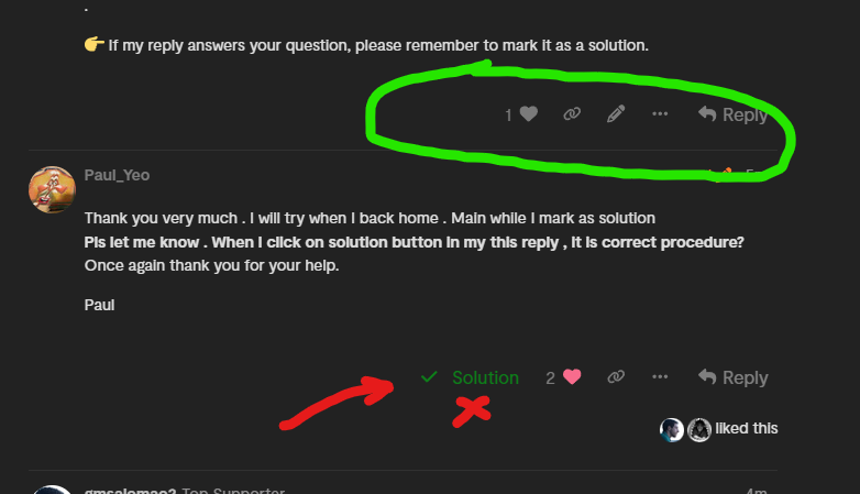

You actually have to mark my reply as the solution :sweat_smile:
You marked your reply
I still can not find where to mark as solution? Can share screenshots? I am use iOS
Somewhere on the green circle. But first you have to remove your solution.
This is correct answer , I need to mark as solution , but unable find the button .
I can only find the solution after I reply the msg .
Which is not correct.
