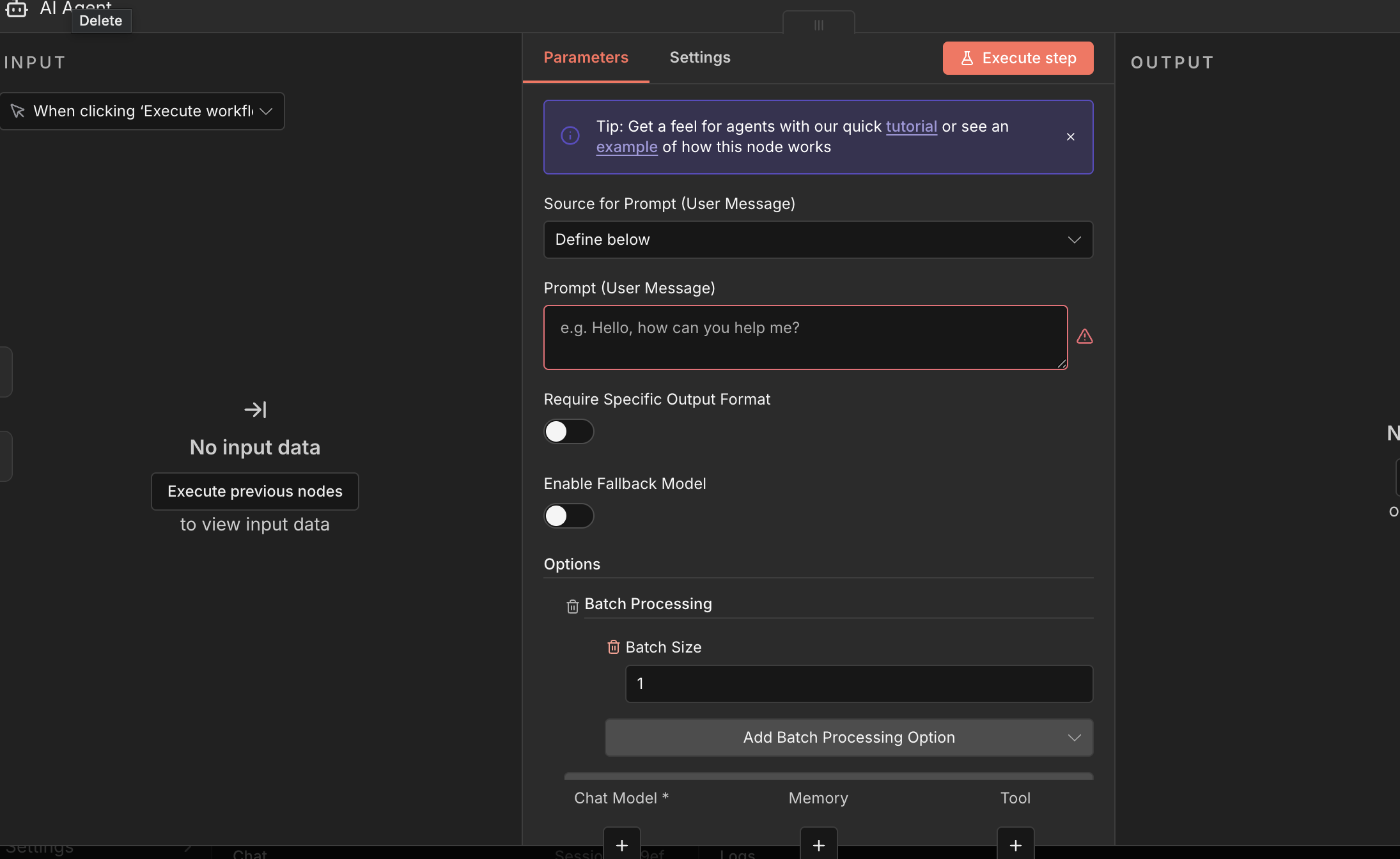

If you go to options in the ai agent node you can set a batch size, which will lighten the load at once. There isn’t a max timeout option, but set the batch size to 1 and let me know how that works!

It looks like he is using the n8n cloud version - on my self hosted community edition, i can change the timeout for the OpenAI Chat node, but it seems you cannot add that parameter in the cloud version.
P.S.: i just found that on my community edition, the OpenAI node has a default timeout of 60 Seconds, whereas the OpenRouter node has a default timeout of 360 Seconds - i don’t know if this is also the case for the cloud version, but maybe it could be a workaround to set up an OpenRouter Account and access ChatGPT via OpenRouter. Does anybody have any experience with this?
I use cloud and self host, but thats a very valuable find. You could theoretically setup a webhook server on the self host, process the data on the self host, and send it back to cloud and you could change the timeout on self host.
