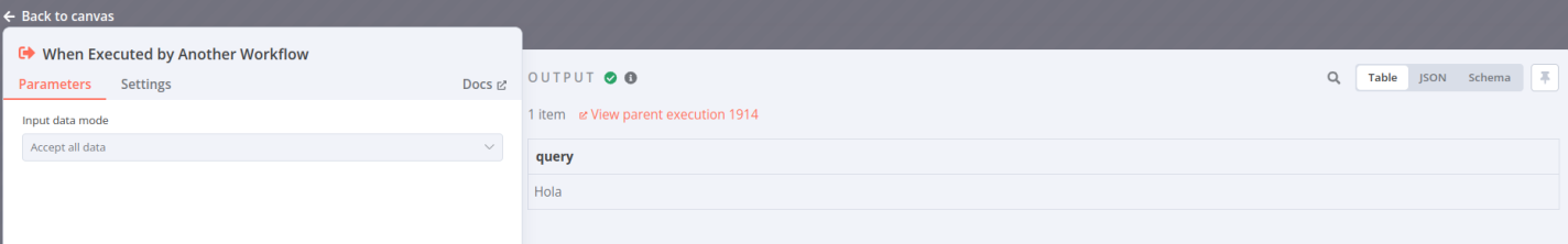

However, when calling the workflow_tool , the AI agent only sends {{ $json.chatInput }} , even though I explicitly instruct it in the system prompt to send {{ $json.chatInput }} + {{ $json.sessionId }} to the workflow_tool .
I have attached an image showing what the workflow_tool receives when a message is sent from the chat. As we can see, there is no reference to the memory ID.
This is necessary because, in order to implement memory in the workflow_tool , I need to provide the sessionId from the parent node.

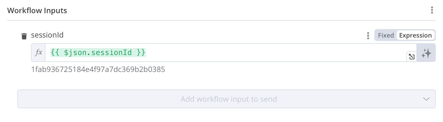

What you can do is just use an expression in your Workflow Tool:

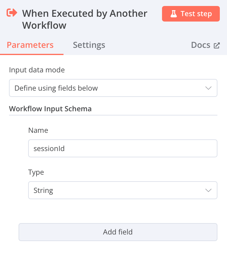

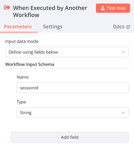

This will pass on the session ID to the workflow that you’re calling. Make sure it can accept it, by specifying the fields on the Workflow Execution Trigger:
Hope this helps!
