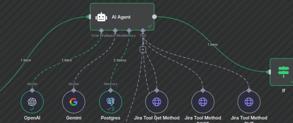

Hello everyone, I’m currently using an Agent that calls tools on a Jira Server. However, I’m still facing an issue that I haven’t figured out how to solve: when the AI calls the tool several times to fetch information or creates one or two items, it starts responding as if it has actually performed the action, even though it hasn’t.
For example, if I ask it to create a task in Jira called “Task 1,” and then later ask it to create a new task called “Advanced Task 1,” it skips the tool call and directly responds as if it has created it, simply based on what’s in memory instead of actually performing the creation.

What i can confirm is that agent node version 2.2 with Gemini model 2.0 was working better 8/10 calls the tools(dues to memory low limit)…
Now i chnaged the agent node to version 3, and the Gemini 2.0 was failing 2/10 calls the tools * USING SAME SYSTEM PROMPT.
I kept agent node version 3, and i switched the model to 2.5 and now 7/10 calls the tool…
Summary, with the latest agent node version, i needed better model on Gemini.

One thing you could try is reducing the “Sampling temperature” down to 0, that generally makes them perform in a more deterministic way.
I fixed it by using a newer and better model, and although the cost is quite high, I no longer encounter this issue. My advice is: if you want to optimize costs instead of using tools directly, ask the AI to return a JSON response and then pass it through condition-checking nodes to execute according to the tool type it provides. Continue this process until the tool type corresponds to the final step you want — that way, the AI agent doesn’t have to worry about whether or not to call a tool; it simply acts as the commander.

Yes, if we separate AI and only return Json, executing any tool is quite efficient. But it is making it a bit difficult for non-professionals at my company to build, so I am temporarily using a more expensive model.
