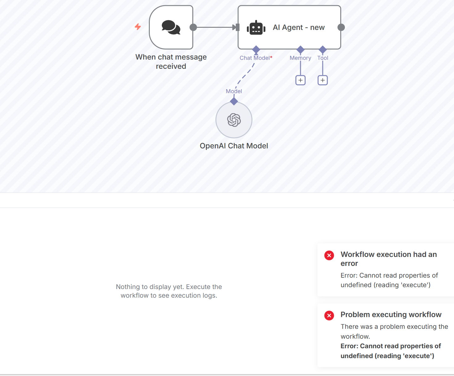

I have a problem with a new AI Agent node in my workflow. The workflow hangs indefinitely and eventually throws a
Error: Cannot read properties of undefined (reading ‘execute’) error.
If I copy an AI Agent node from an older workflow into a new workflow, it works without any issues. The Error only appears when a new AI Agent node is added from the node menu.

I’ve already tested these scenarios, and the issue is still present:
  • Model Selection: I am using the most current and recommended models
  • API Connection: I have not only disconnected and reconnected the OpenAI Chat Model node, but I also created a new API key and rebuilt the workflow several times from scratch. The result is always the same.
  • Memory/Tools: I confirmed that the presence or absence of Memory/Tool does not affect the issue; the workflow fails either way (in the screenshots showing the setup without them).

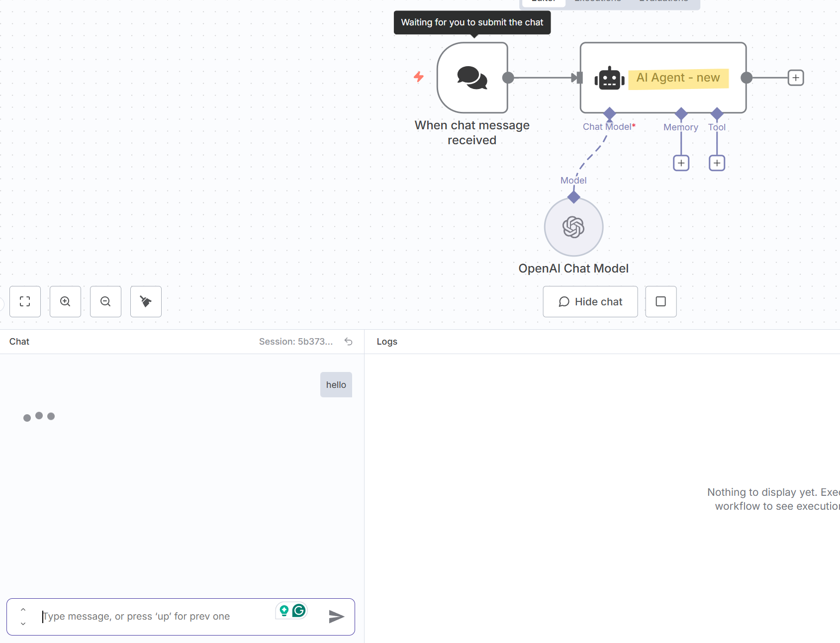

With the problematic new AI Agent node, the trigger data from ‘When chat message received’ is not even reaching the agent.
In Editor mode, the process just spins without executing, and in the Executions log, it instantly throws the Error: Cannot read properties of undefined (reading ‘execute’).
When I use the same settings (model, trigger) but replace the node with an AI Agent node copied from an old, working workflow, everything functions perfectly.
And whenever I add the new AI Agent node (the one currently available from the nodes panel) to any workflow, the entire flow and any individual node in the workflow stop working due to an error, until the new AI Agent node is removed from the workspace.

I noticed that whenever I add the new AI Agent node (the one currently available from the tools list) to any workflow, the entire flow and any individual node in the workflow stop working until the new AI Agent node is removed from the workspace. In other words, the error occurs both when using ‘Execute Workflow’ and when using ‘Execute Step’.
