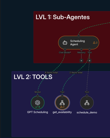

I’m building a Sales Chatbot using the AI Agent node (LangChain) with a multi-agent architecture (Orchestrator → Sub-Agents → Tools).

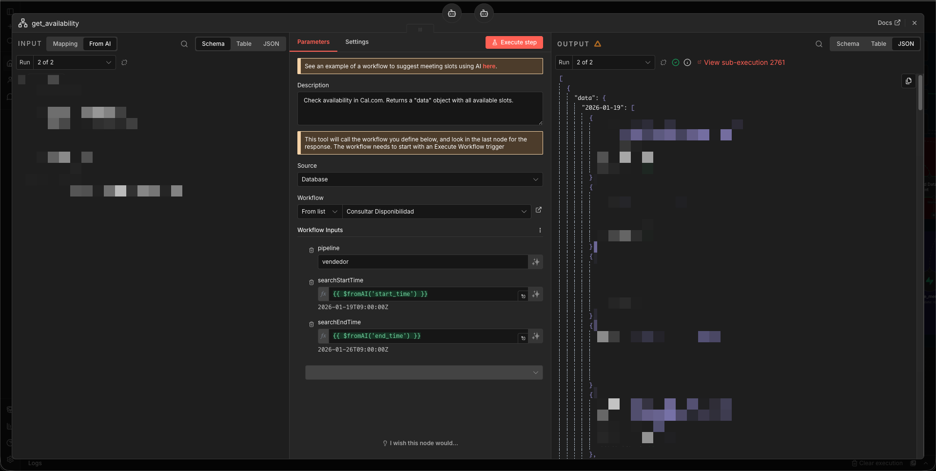

I am facing a specific issue with my Scheduling Agent. It has a tool called get_availability which triggers a workflow to fetch available slots from Cal.com.
The Problem:

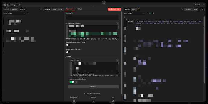

The tool executes perfectly. I can see in the execution inspector that the get_availability node returns a valid JSON object containing the available time slots. However, the AI Agent (LLM) seems to “ignore” this data. It either responds that there are no slots available or hallucinates/invents time slots that are not in the JSON.
The Setup:
  • Model: GPT-4o-mini
  • Architecture: The Orchestrator calls the “Scheduling Agent,” which calls the get_availability tool.
  • Tool Output: The tool returns a JSON object structured by date.
What I observe:
  1. The Agent calls the tool correctly.
  2. The tool returns data like this (verified in the Output Inspector):
    JSON
      "data": {
        "2026-01-19": [
            "start": "2026-01-19T12:00:00...",
            "seatsRemaining": 50
  3. Immediately after receiving this, the Agent generates a response saying it couldn’t find information or generates a random time, completely disregarding the JSON above.

Screenshots:
