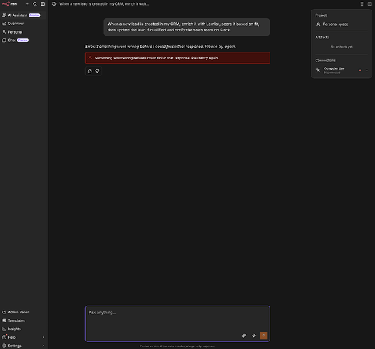

I’m using the AI Assistant (Preview version) on my instance joaquinito2708.app.n8n.cloud and it’s not working: whenever I send any message it returns the error “Something went wrong before I could finish that response”.
When reviewing the network requests, I can see that the GET /rest/instance-ai/credits endpoint returns a 500 error, while all other calls (chat, threads, preferences, gateway/status) respond with 200. It seems like there’s an isolated issue with the AI credits verification on my account.

Do you have any AI credits in the first place, @Joaquin_de_Santibane ?
n8n cloud only give you builder credit, not AI credit
This confirmed what I had suspected
I was wrong
Possibly, or has your credit run out?
Ophir from n8n here.
This is a fix we’re working on right now.
When you run out of credits the error message right now is a generic message. We’re fixing it so it will specifically say you’re out of credits.
