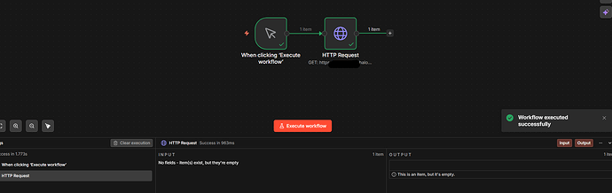

However, even with a simple workflow and correct permissions in HaloPSA I get no data returned in n8n. The workflow runs and says successful.

have you checked what halopsa is actually returning? try adding a debug node right after the http request to see whats coming back. might be empty or structured differently than you expect. whats the raw output look like?
I haven’t tried using a HTTP request yet (never used one before, but happy to learn).
I am trying to use the n8n provided dedicated HaloPSA node
ah gotcha, sorry for assuming http request! the same idea applies with the built-in node though — when you run the workflow, click on it and check what the actual output looks like. does it come back empty or show something unexpected?
Not sure how to drive a http request
If I add one, with correct creds to access HaloPSA, the workflow succeeds, but nothing is returned

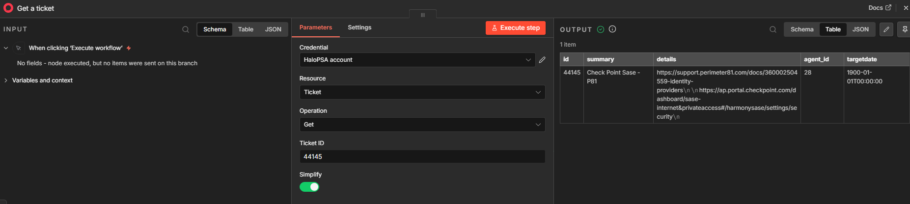

If I use the n8n provided HaloPSA node, and I just request a single ticket ID, that succeeds
But I would like to ask questions and have KB articles or tickets returned.
No worries! Before jumping to HTTP Request, try this: click on your HaloPSA node in the editor, run the workflow, then right-click on the node output and check what data it’s actually returning. Is it empty, or structured differently than expected? That’ll tell us if the node is working correctly or if there’s an auth issue. Once we know what’s coming back, we can decide the next step.
Good progress! For the AI chat part, you’d add an AI Agent node that calls the HaloPSA node as a tool. The AI Agent will take the user’s question (“Find KB articles about shared drives”), call the HaloPSA tool with the right parameters, and return the results. But first, make sure the basic HaloPSA node + HTTP Request are returning reliable data—then the AI layer becomes much simpler to add. Want to post your current workflow setup so we can debug the data issue first?
