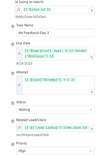

The update node successfully updates “Due Date” and “Task Name” fields but the “Attempt” field (Number type) remains unchanged at 0, even though the expression should increment it to 1.
What I’ve Tried:
Multiple expression formats: {{ $json.Attempt + 1 }}, {{ $json[“Attempt”] + 1 }}, {{ parseInt($json.Attempt) + 1 }}, {{ $json.fields.Attempt + 1 }}
Verified the Attempt field exists in Airtable and has type “Number”
Confirmed the input data contains “Attempt”: 0 in the correct data structure
Tested different ID matching expressions for the record lookup
All other fields update correctly using similar expression syntax
Current Configuration:
Columns to match on: id
ID (using to match): {{ $(‘Search Task Records’).item.json.id }}
Attempt field: {{ parseInt($json.Attempt) + 1 }}

Hi @JoanW,
After the Gmail node executes, there’s no such thing as {{ $json["Attempt"] + 1 }}
The Attempt value comes from the node called Get a Task,
so the correct way to reference it will be:
{{ $('Get a Task').item.json.Attempt + 1 }}
so just edit that in the last airtabes nodes

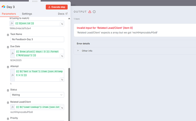

replace it with:
Sorry, I see what you’re saying. I did that and got this
“errorMessage”: “Invalid input for ‘Related Lead/Client’ [item 0]”,
“errorDescription”: “‘Related Lead/Client’ expects a array but we got ‘recHiHqmzsdduP0o8’”,

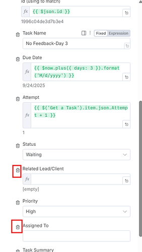

I removed this and still got an error:
“errorDescription”: “‘Related Lead/Client’ expects a array but we got ‘’”,

Okay, that’s another error now,
Change that column type to ‘string’ in Airtable if you don’t intend it to be an array.
I just added it and saw it created an error so I deleted it. I don’t need it for this to work I don’t think. It uses the Airtable ID.
Nice, also delete the fields you don’t want to update:
Then try executing the workflow, it should work, and the “Attempt” column should be updated..
I deleted them and ran the workflow. It went smoothly until the Switch. After the Switch nothing happened. I executed the 1st Nudge node but there wasn’t any output even though the node executed successfully.
I also deleted the 0s in the Airtable CRM and nothing has been entered there.
Do not delete the 0s in Airtable, because the switch node checks for the values 0, 1, 2, 3
If the value is empty, the workflow will stop at the switch since there is no case for that.

Check if your expression entered in Column “Related Lead/Client” is an array
I don’t have anything in “Related Lead/Client”
