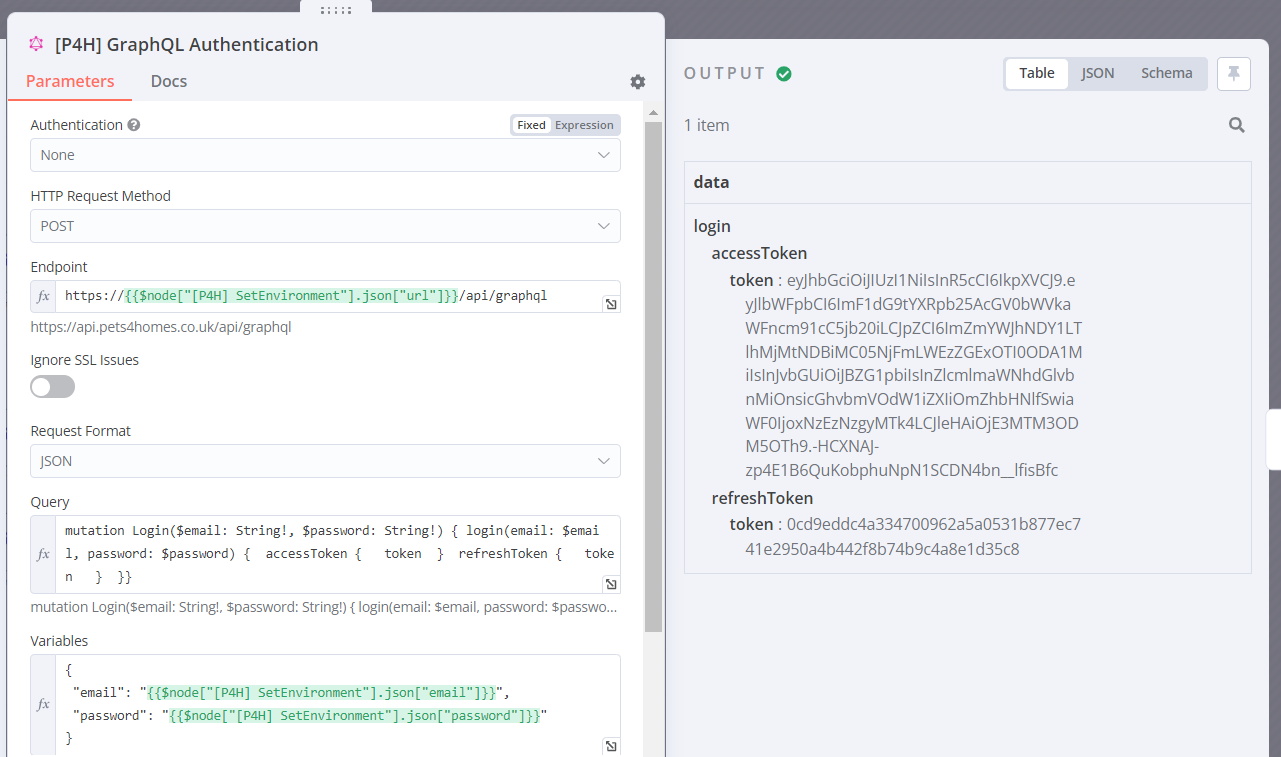

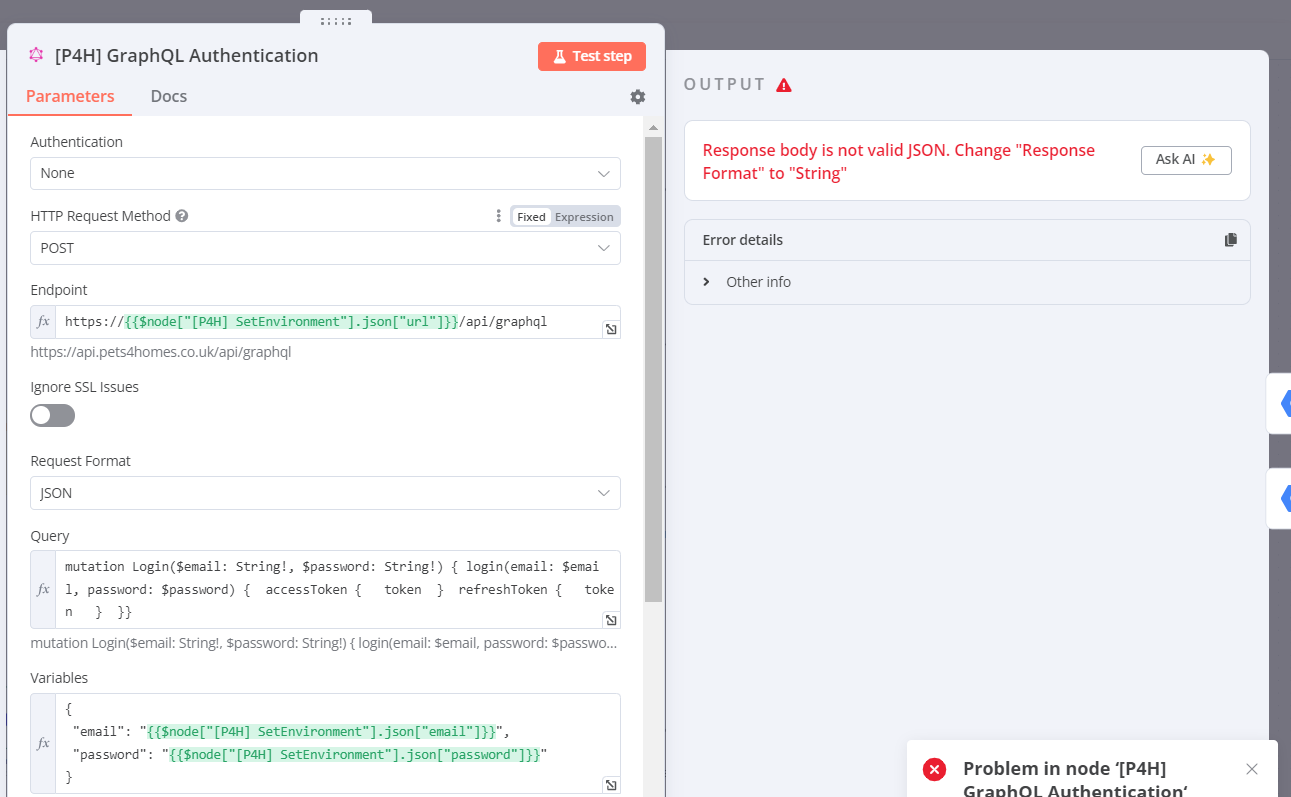

Hi Liam, thanks for your message. They appear to be failing on the same GraphQL Authentication step with the message "Response body is not valid JSON. Change “Response Format” to “String”.
These workflows have been running fine for months without this error.

Hi Liam - that didn’t work. We have the same GraphQL node in-use for 4 other endpoints and the only difference between them is the endpoint - even login details are the same. Only one of the endpoints is suddenly experiencing this failure while the others are still outputting a valid JSON response body.
Converting the output to string from the node with a failing endpoint outputs a text with <!DOCTYPE html><html lang="en-US"><head><title>Just a moment...</title><meta http-equiv="Content-Type" content="text/html; charset=UTF-8"><meta http-equiv="X-UA-Compatible" content="IE=Edge"><meta name="robots" content="noindex,nofollow"><meta name="viewport" content="width=device-width,initial-scale=1"><style>*{box-sizing:border-box;margin:0;padding:0}html{line-height:1.15;-webkit-text-size-
More details for the error:
Stack trace
NodeOperationError: Response body is not valid JSON. Change "Response Format" to "String" at Object.execute (/usr/local/lib/node_modules/n8n/node_modules/n8n-nodes-base/dist/nodes/GraphQL/GraphQL.node.js:446:35) at processTicksAndRejections (node:internal/process/task_queues:95:5) at Workflow.runNode (/usr/local/lib/node_modules/n8n/node_modules/n8n-workflow/dist/Workflow.js:728:19) at /usr/local/lib/node_modules/n8n/node_modules/n8n-core/dist/WorkflowExecute.js:660:53 at /usr/local/lib/node_modules/n8n/node_modules/n8n-core/dist/WorkflowExecute.js:1062:20

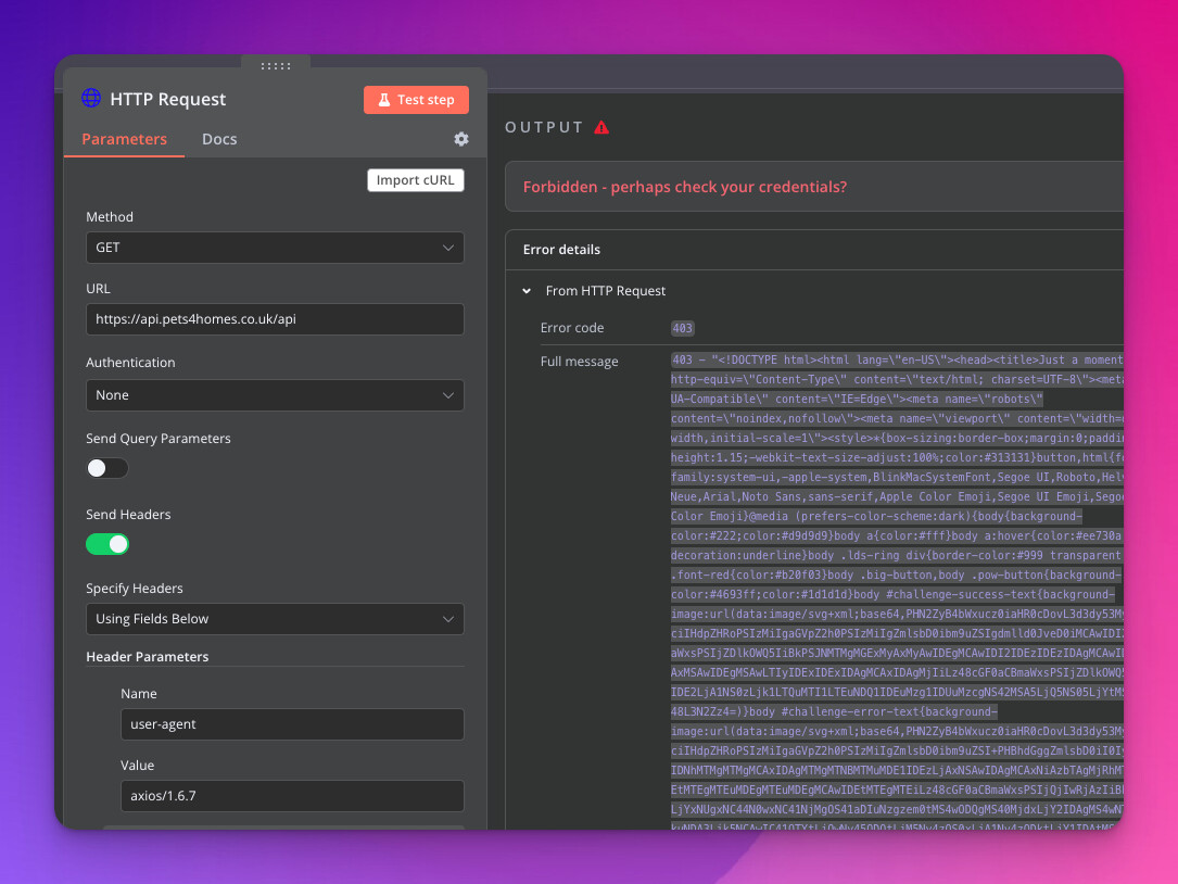

Can you save it to a file and share that file? Have you tried the same request from Postman or similar as well to make sure nothing has changed with the API as well like maybe something like Cloudflare being introduced?

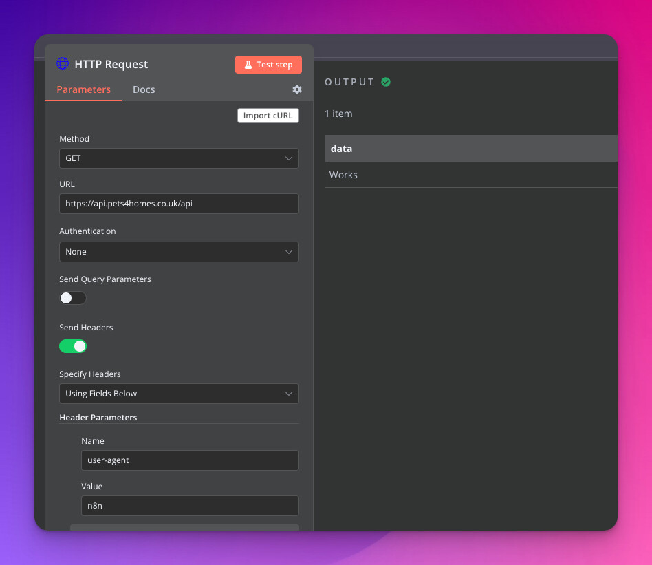

Actually this is exactly the problem, Loading https://api.pets4homes.co.uk/api in my browser is file and from n8n and curl it fails with a similar looking html page but as soon as I add a user agent header it works.
I suspect they have recently updated their Cloudflare rules to block certain user agents or agents with only a few characters in the name…
We send axios/1.6.7 as the user-agent which fails…
By changing it to n8n it works
@Jon Fantastic - that seemed to work! I’ll update this everywhere on our end. Thanks for being a lifesaver.
