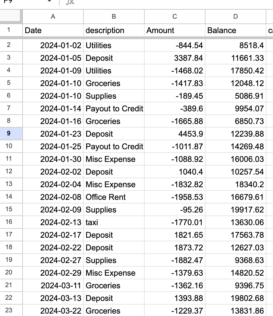

I am trying to very simply output a modified column for a spreadsheet. My plan is more complicated but trying to make a simple example so we can debug it.
No matter what I do, i always only get one item output. I want the output to be an entire table with a modified column.
Why do i only get one item as the output?

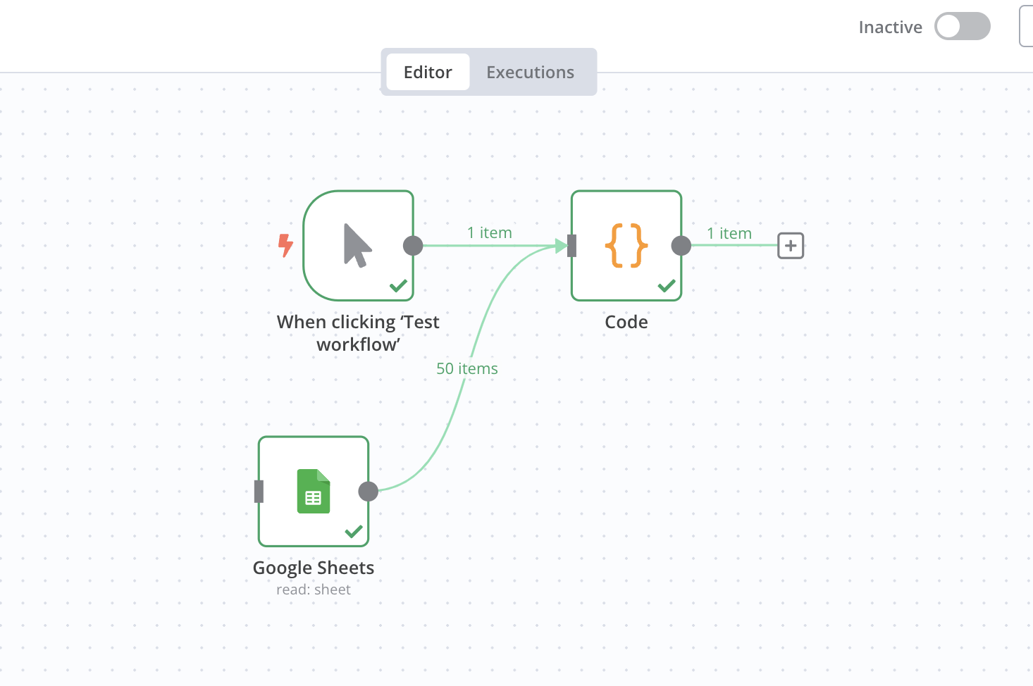

Your test appears to be “faulty”. In any case, the issue is not with the code. It works as per your code logic - an extra property added to each incoming item. Therefore, the issue is likely rather with your Google Sheet node.
As per your screenshot, when you run the test, you actually exclude the spreadsheet data and thus only one item is returned because in this case the input data to Code node is just [{json:{}}]. If you run the following code you will get the same result:

If you want to debug the issue, do the following
  1. Read the data with Google Sheets node
  2. Pin the data, so you do not make more API calls and work on the same set of data
On the side note, to demonstrate the Code works fine (many items returned), try the following workflow.
How am I excluding the spreadsheet data? I don’t understand this part.
It says 50 items passed through from the Google Sheets node.
