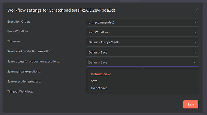

Are you logging succesful executions? Depending on your instance settings, you may have to change the workflow settings to do so:
After this, you can inspect the execution data by double-clicking any node in a past execution. I also recommend registering your instance to get access to some additional features including ‘debugging to editor’ which lets you copy the values of previous executions to the editor for debugging.

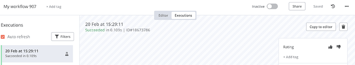

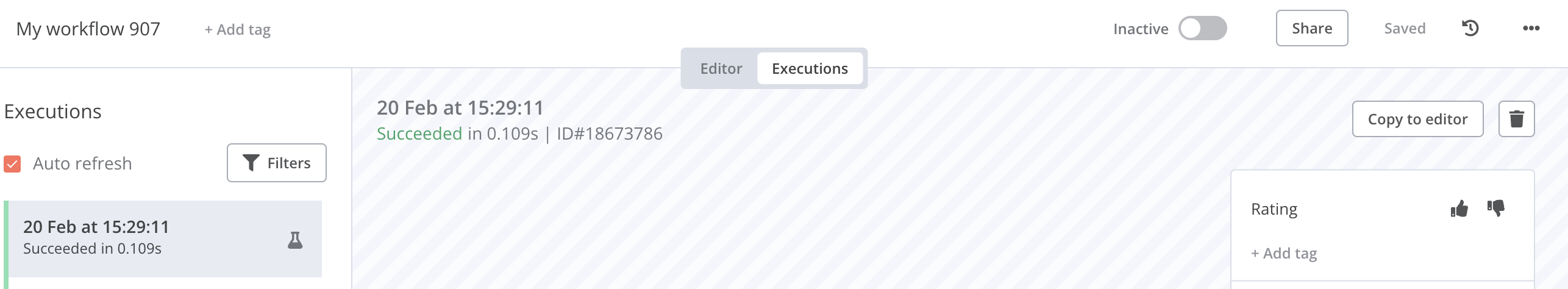

You’ll find it at the top-right of the screen when you’re looking at an execution. For failed executions it will be labeled ‘Debug in Editor’:
Hmm, so clicking “Copy to editor” opens up the editor view and I see the nodes. I don’t see any data though. Clicking into a node I then see the usual “Listen for test event” buttons, but no data of that execution.
“Debug in Editor” is the same thing, except it shows me an error message. Still no data.
