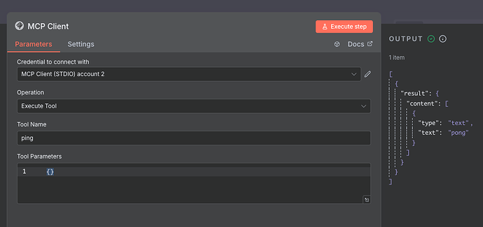

I just tried and was able to connect and use one of the mcp servers:
I chose Echo Server | Smithery for tests as the most simple and not requiring additional resources.

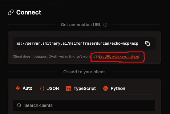

I created an account, I got the url with keys:
Then I created a credential in n8n (use HTTP Streamable type), and finally:
and
