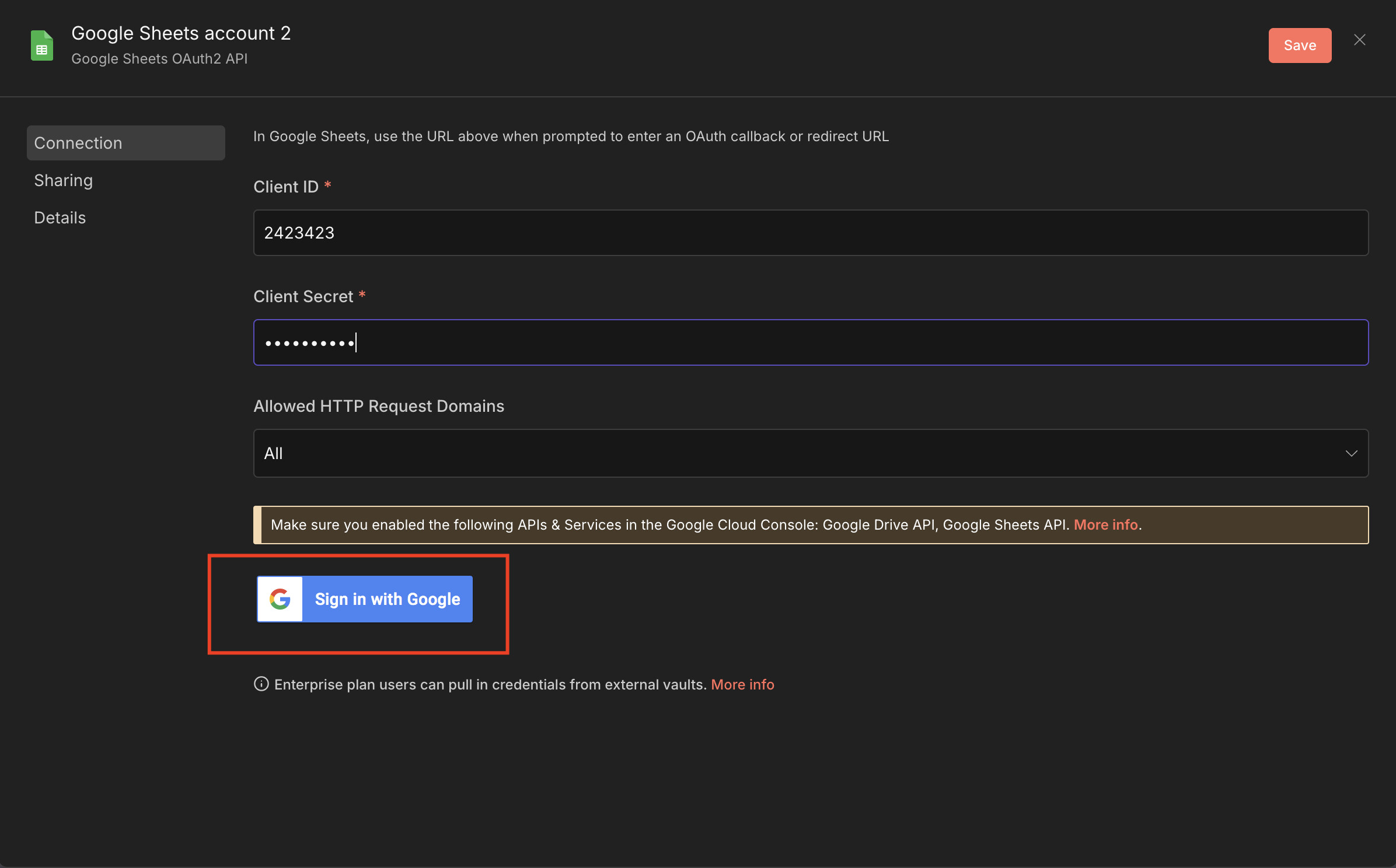

Im having trouble linking my google sheets API. The key and secret have been entered, but i cant see my individual sheets, or rows. the message i keep receiving is Could not load list
Unable to sign without access token

Hi @Evan_Young,
After you set the client id and secret, make sure to click the button at the bottom to actually log into your google account. This is what will set the token which is related to the error you’re getting
