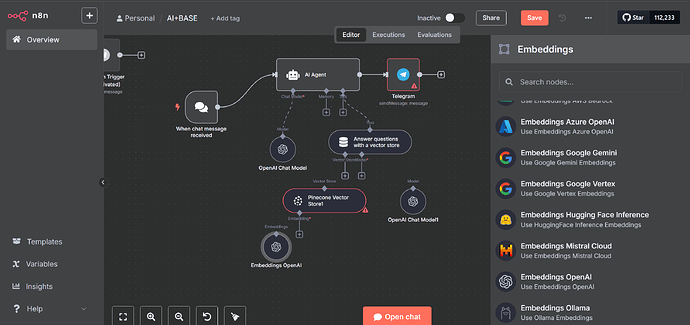

Hello everyone! Does anyone know how to connect QWEN Embedding via the official API in n8n? Or maybe it’s possible to create an equivalent workflow using HTTP REQUEST nodes? I would appreciate any information!
I’ve attached a screenshot of my workflow, a link to the documentation, and a YouTube link where a guy connects QWEN Embedding via Ollama.
From the documentation, it looks like it should be possible to send an http request to the official API for the embedding model.

Thank you for your answer, but I don’t understand how to connect the HTTP Request node to the Pinecone Vector Store node.
Well, since after sending above mentioned requests you would end up with embeddings already and wouldn’t need a pinecone vector store node. You’d have to insert embeddings directly via pinecone API as well.

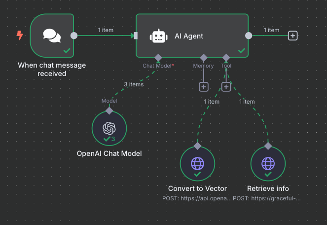

Sorry, may I ask you to assemble the workflow as in the picture, but without using the nodes highlighted in yellow? Instead, please use HTTP request nodes.
Sure thing, this is how it would look like:
And this is the workflow
This is how I tested:
  • I uploaded a document to Pinecone
  • I configured AI Agent with instructions for how to get the vector and how to retrieve info from Pinecone based on that vector.

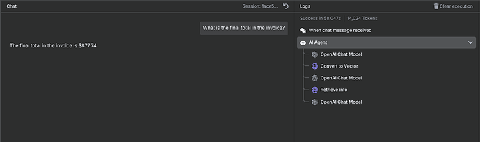

And this is my conversation with the model:
Note: I used 512 dim openai for embedding (both ingesting and and retrieval.
Hope it helps!
