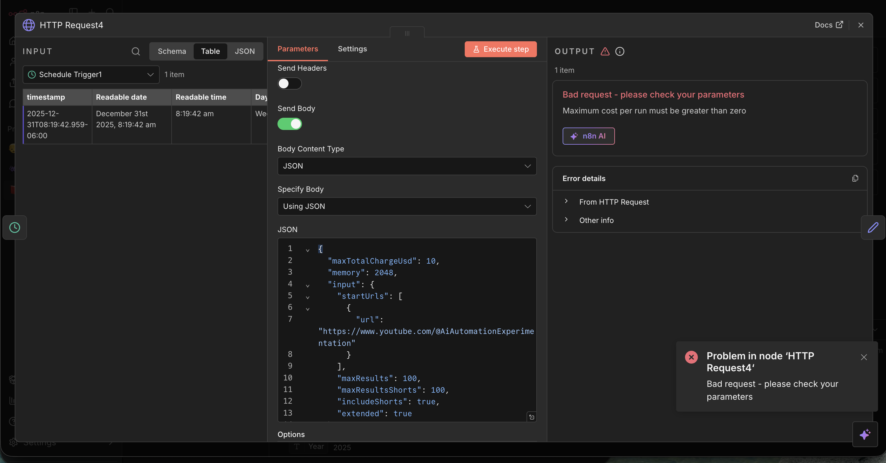

Every since last night around 10PM, my apify node started giving me this error: Bad request - please check your parameters. At this time i was using the apify community node. Then, I switched to a https request and no matter where I put the cost value, I still get that error.
Maximum cost per run must be greater than zero
It won’t do anything since the error started.
n8n version: 2.1.4
Running n8n via n8n cloud,
Operating system: MacOS Tahoe

I tried it, it’s still erroring, did I maybe type it wrong?
Use this at the root level of the body @achamm
“maxTotalChargeUsd”: 10,
“memory”: 2048,
“input”: {
“startUrls”: [
{ “url”: “https://www.youtube.com/@AiAutomationExperimentation” }
“maxResults”: 100,
“maxResultsShorts”: 100,
“includeShorts”: true,
“extended”: true
Yes
maxTotalChargeUsd is placed properly, so the request setup itself is right.
If you still see the error after that, it’s not the structure anymore (it would be an Apify side issue like account limits or billing), but the image/config you showed is correct.

I’ll have to look at my billing, maybe that is why it’s erroring.
I’m going to mark your solution as correct since you helped and your probally right its an apify issue.
achamm
January 1, 2026, 5:45pm
9
I figured out the real issue, it was because of my billing!
