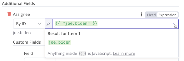

For example, my name is Joe Biden.
If i type {{“joe.biden”}} in “By ID”, the response is as follows.
400 - {“errorMessages”:[],“errors”:{“assignee”:“user ‘joe’ does not exist”}}

The ID for a jira assignee isn’t their username it is normally some numbers followed by a GUID so something like 123456:7710de47-1472-4420-9b7e-ce422bb94d97. Does the assignee list not work at all? I have just given it a quick look with my test jira cloud account and it appears to find me as expected.
Looking at the API documentation it should be the same for self hosted Jira as well. If you get an issue under the assignee or creator you should see a userId which is the value to use.

And after i select someone, switch to “By ID” and that person’s AD account name will be printed out.
If i send it like this, it works well.
However, the problem is that if the user ID contains a ". (e.g., “areum.wei”)
This seems to be going to “areum.”
That’s why I felt I needed a way to request a string containing “.”
Ahh ok that is interesting, I wonder if we are changing something there or if it is something the API doesn’t like. I will free up some time to take a look, For now you could try using the http request node to see if that works around it.
