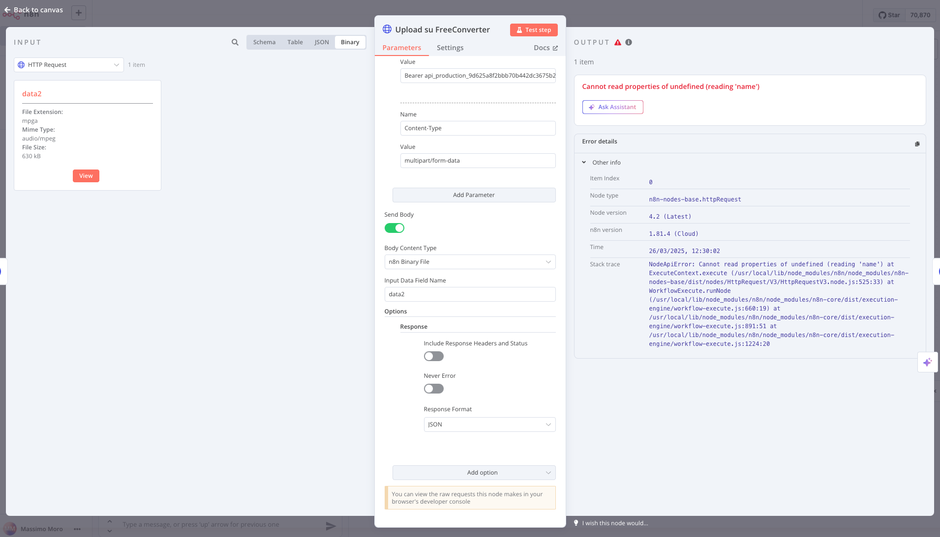

Hello, I need to convert a file generated with the ElevenLabs API from MP3 to AAC format. I’m trying to use the FreeConverter API, but I’m unable to correctly upload the binary input file. Can anyone help me? Thanks!
Did you try n8n binary file option?
Yes, another error.
Most likely that’s because data2 binary data is missing fileName property.
Try to add one using Code node.
However, the error mentions name property. I wonder what are other settings in your node that may refer to name?
Could you post the node using the </> button here?
Hmmm, I don’t know how to add the Name property using the Code node. I’ll send you the other nodes.

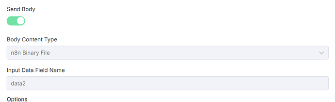

Two options here:
  1. Copy node from my previous post and paste it into your workflow and wire it up accordingly.
  2. Check the node from my previous post for settings and code used in there.

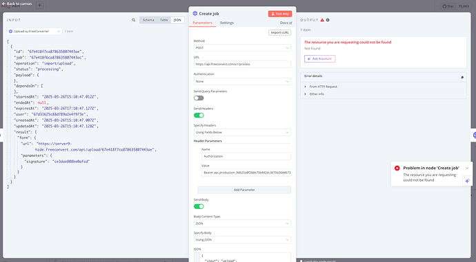

Thank you. Still, having no sample data, hard to tell what the data structure is and how to fix it.

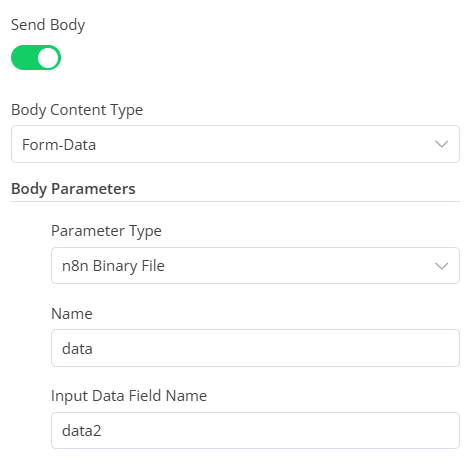

What will happen if you remove Content-Type header and Options/Response completely?
If this won’t fix it, try adding name prop like this.
The freeconverter api may expect a bit different structure of the request.

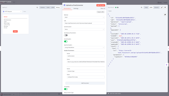

Hi Olek, if you send me your email address, I can send you the API keys so you can try it yourself directly. You would be a great help to me. I’ll also send you the sample file generated by ElevenLabs.

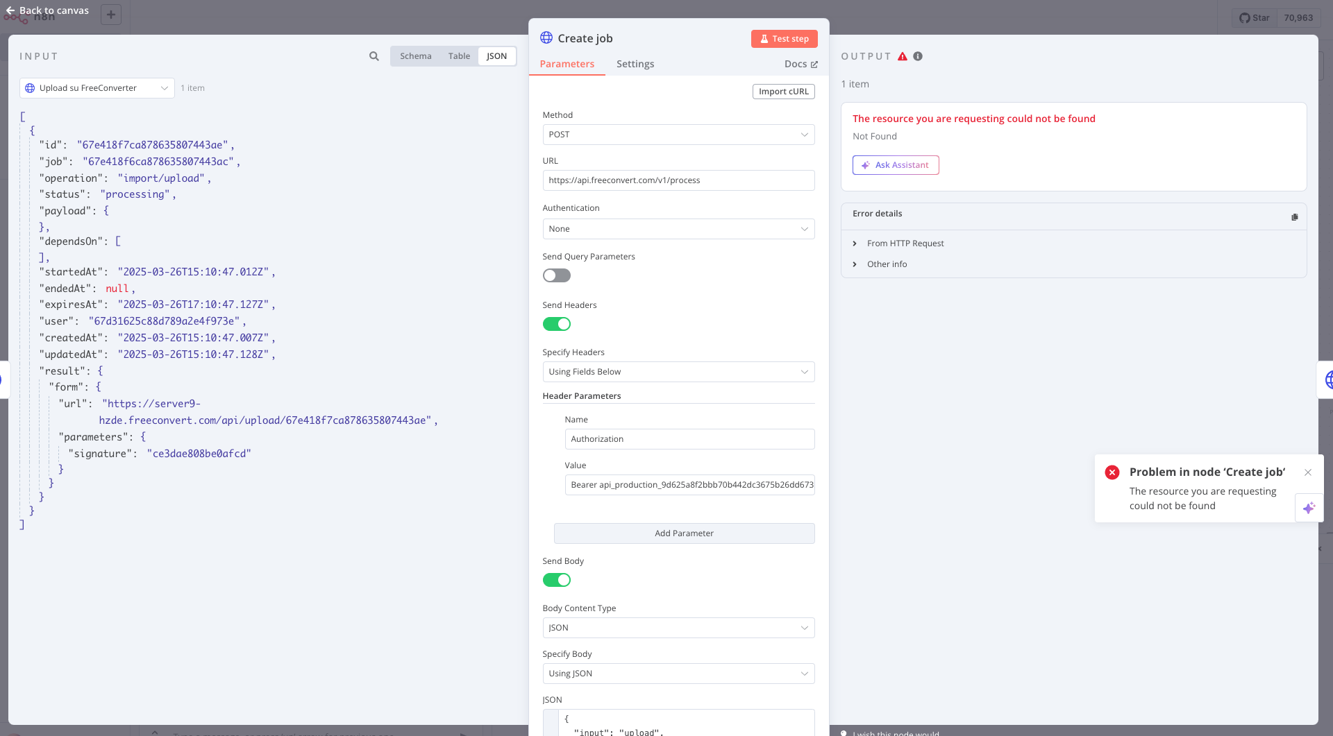

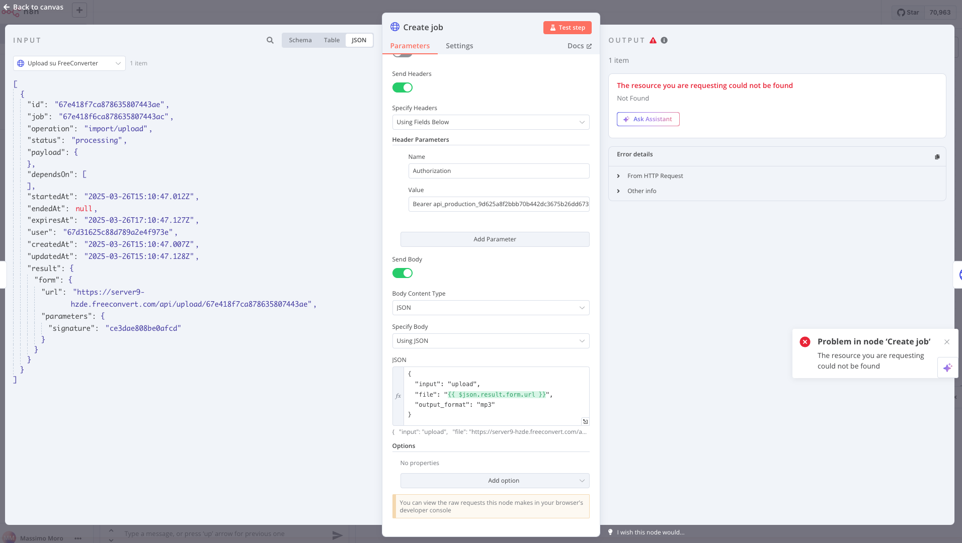

Allright, this looks like a succesful request. Solved?
No…

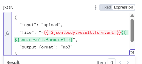

Wrong data reference:
Original is red, correct one is green.
But I mean this is a different question. Maybe you wanted to post in Help me Build my Workflow - n8n Community
Yes, I had already fixed it. But the error is not there.
You just need to pay a bit more attention. Every character matters.
Maybe your original file got expired. I will try to look into this later. Need to go.
Meanwhile, try to double-check every step and data point in your workflow.
