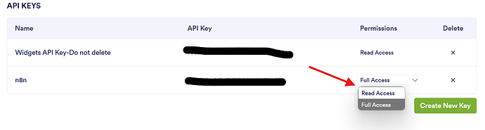

Ensure you have enabled full access:
You’d get the error you got with just read access.
