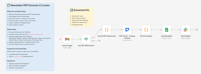

Built a workflow that watches Gmail for PDF newsletters, reads each one automatically, and posts a structured digest to Slack — topics covered, key stories summarized, stats pulled out, trends identified — without opening a single PDF.
What it does
PDF newsletter arrives in Gmail → checks for PDF attachment → extracts the PDF → analyzes content → formats digest → logs to newsletter library → posts to Slack
Checks Gmail every hour. Takes about 12-15 seconds to process each newsletter.
Smart attachment detection
The workflow includes an IF node that checks whether the email actually has a PDF attachment before doing anything. Non-PDF emails or emails without attachments are filtered out automatically — only genuine PDF newsletters proceed.
The Code node finds the first PDF in the email’s binary attachments regardless of how the attachment is named, so it works even when the filename isn’t predictable.

What lands in Google Sheets
Each row: Newsletter, Subject, Sender, Received Date, Topics, Key Stories, Stats & Data, Trends, Full Analysis, Processed Date
Your entire newsletter archive in one searchable sheet. Filter by Newsletter to see all issues from one publication. Search Topics column for specific subjects across all newsletters.

Step 1: Get your PDF Vector API key
Sign up at pdfvector.com — free plan works for testing. Go to API Keys and generate a key.
Step 2: Create your Google Sheet
Headers in Row 1:
Newsletter | Subject | Sender | Received Date | Topics | Key Stories | Stats & Data | Trends | Full Analysis | Processed Date
Step 3: Import the workflow
Download JSON from GitHub → n8n → Import from File.
Step 4: Configure the nodes
Gmail Trigger:
  • Connect Gmail account (OAuth2)
  • Polls every hour by default — change to everyMinute for real-time processing
  • Add a Gmail filter in the search query to target specific senders if needed:
  • from:([email protected]) has:attachment
  • has:attachment filename:pdf for all PDF emails
Has PDF Attachment?:
  • No config needed — automatically filters emails without PDF attachments
Extract PDF Attachment:
  • No config needed — finds first PDF attachment regardless of filename
PDF Vector - Analyze Content:
  • Add new credential (Bearer Token)
  • Paste your API key
  • Uses Ask operation with structured 5-section prompt
Format Analysis:
  • No config needed — parses the 5 sections automatically
Log Newsletter:
  • Connect Google Sheets
  • Paste your Sheet ID
Share Digest:
  • Connect Slack
  • Select your content or digest channel
Step 5: Test it
Send yourself an email with a PDF newsletter attached. Check Slack and your Sheet within the next polling cycle.
