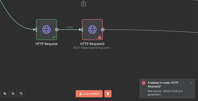

Bad Request - Incorrect Filename?

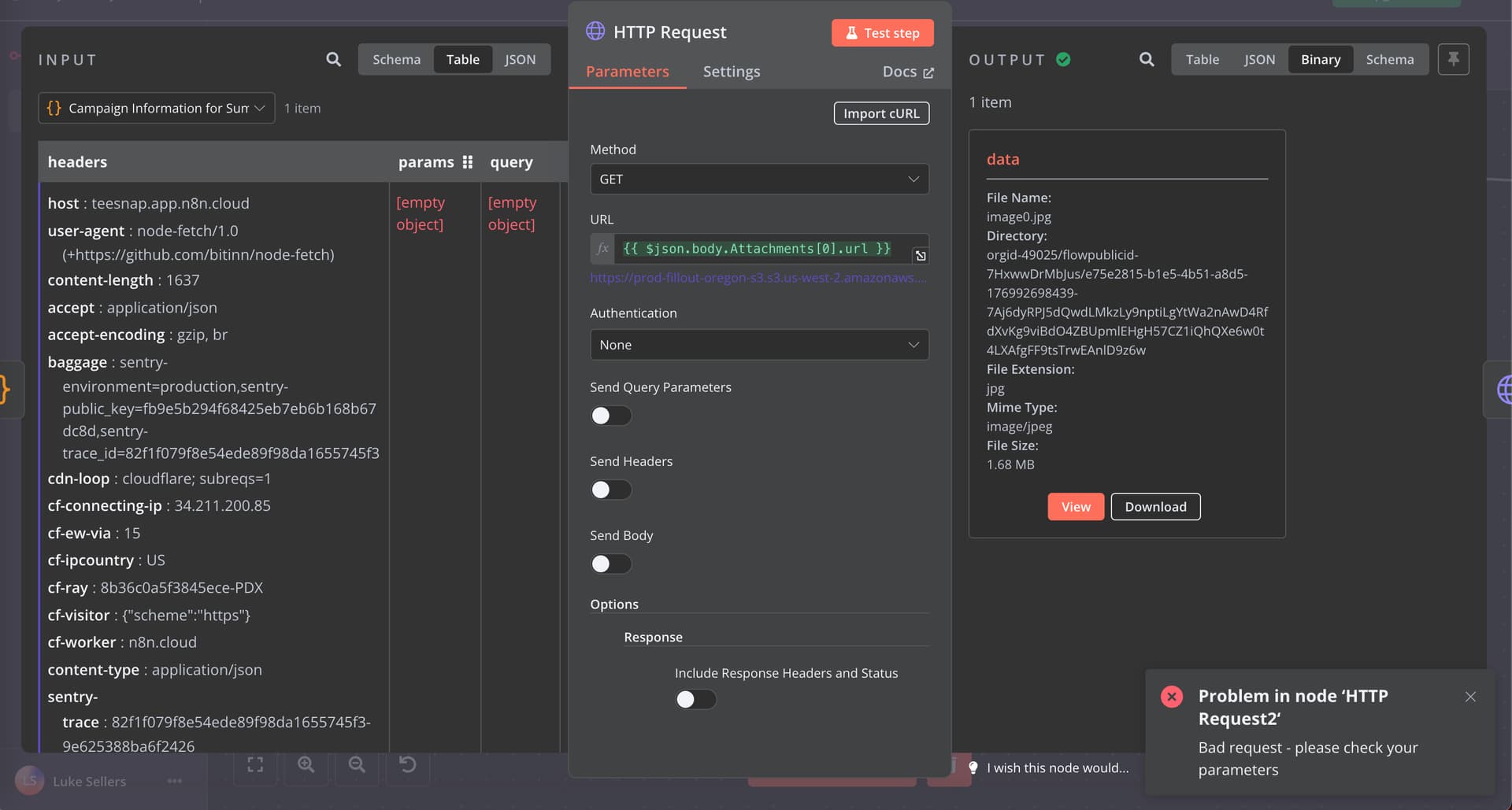

Trying to download a file and then upload a file via HTTP Request Node(s).

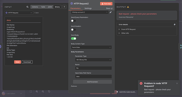

" Bad request - please check your parameters
Incorrect filename!"
Error code
400
Full message
400 - "{\"err\":\"Incorrect filename!\",\"ECODE\":\"UPLOAD_002\"}"
Request
{ "headers": { "accept": "application/json,text/html,application/xhtml+xml,application/xml,text/*;q=0.9, image/*;q=0.8, */*;q=0.7", "Authorization": "**hidden**", "content-type": "multipart/form-data; boundary=--------------------------102800132227740260862873" }, "method": "POST", "uri": "https://api.clickup.com/api/v2/task/86b1pxkj1/attachment", "gzip": true, "rejectUnauthorized": true, "followRedirect": true, "resolveWithFullResponse": true, "followAllRedirects": true, "timeout": 300000, "formData": { "_overheadLength": 158, "_valueLength": 0, "_valuesToMeasure": [ { "fd": null, "path": "/home/node/.n8n/binaryData/workflows/uAkLjeZTEckKEcdB/executions/592/binary_data/e4e8d326-6cc0-40a5-81a0-5a48c224d853", "flags": "r", "mode": 438, "end": null, "bytesRead": 1678263, "_events": {}, "_readableState": { "highWaterMark": 65536, "buffer": [], "bufferIndex": 0, "length": 0, "pipes": [], "awaitDrainWriters": null }, "_eventsCount": 2 } ], "writable": false, "readable": true, "dataSize": 0, "maxDataSize": 2097152, "pauseStreams": true, "_released": true, "_streams": [], "_currentStream": null, "_insideLoop": false, "_pendingNext": false, "_boundary": "--------------------------102800132227740260862873", "_events": {}, "_eventsCount": 3 }, "encoding": null, "json": false, "useStream": true }

Hey @Luke_Sellers,
Looking at the API docs for the call you are making you are sending a file key but the api expects it to be called attachments and to be an array. Can you try changing this to match what the API expects to see if it helps.
Hey Jon, thanks for the response. This may be a dumb question but I am new to this, how would I convert the “item” or data/file I suppose in this case to an array?
Hey @Luke_Sellers,
Good question, I would try just naming the json field attachments[0] and see if that works if it doesn’t it will be more complicated
Still gave me the bad filename error - I also tried using an aggregate node to create an array, but the http request node then throws an error because it expects a binary file and not an array. Seems like maybe n8n and ClickUp don’t play well together in this instance.
I put quotes around attachments[0] and it gave me a new error
{“err”:“No attachment supplied”,“ECODE”:“ATTCH_039”}
its not taking the binary field
