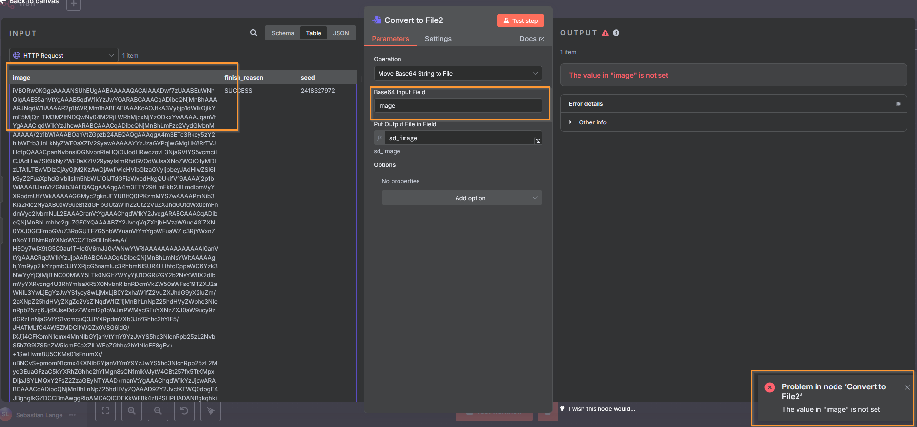

Hello, I tried to search here and on discord but it can’t find a fix. I can’t transform a base64 string to file to then upload it to a S3, when pasting a base64 string and testing it give me an error, but when pasting the same string in any base64 decoder online it works fine.
I’m getting the error The value in “iV…ErkJggg==” is not set [item 0].
Base64 for is generated by a HTTP Google Gemini call, then i try to convert it to a file

The input for Base 64 is not the base64 encoded binary, it’s the Input field name that contains the encoded binary.

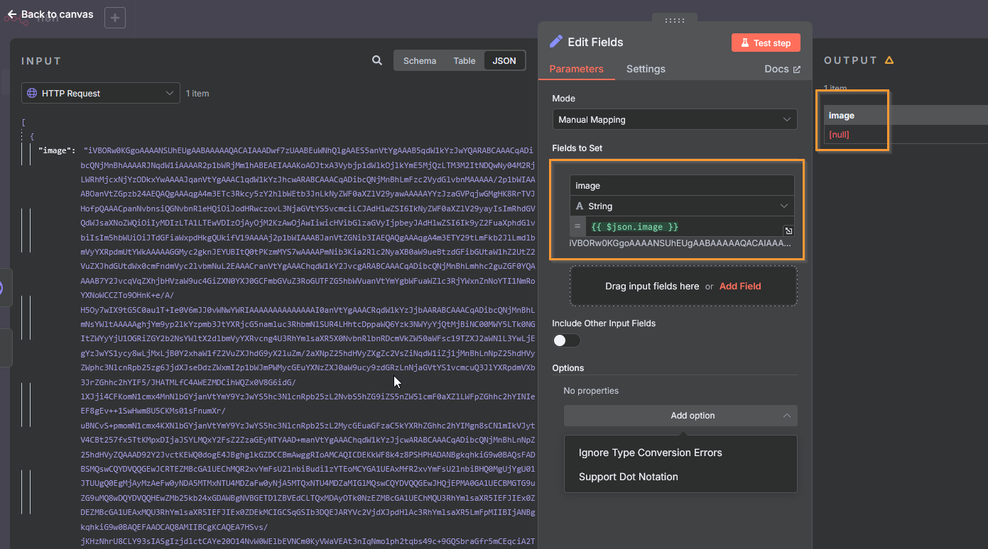

Sorry to hijack this thread, but if have the same issue it seems.
I can hand over a Base64 String to a Set Node or to a Convert to Binary Node, it seems the string is empty everytime. If i copy the Base64-String to a Decoder i get the acutal Value of the String (PNG File).
To Set Node:
To Convert to Node
Do is miss something?

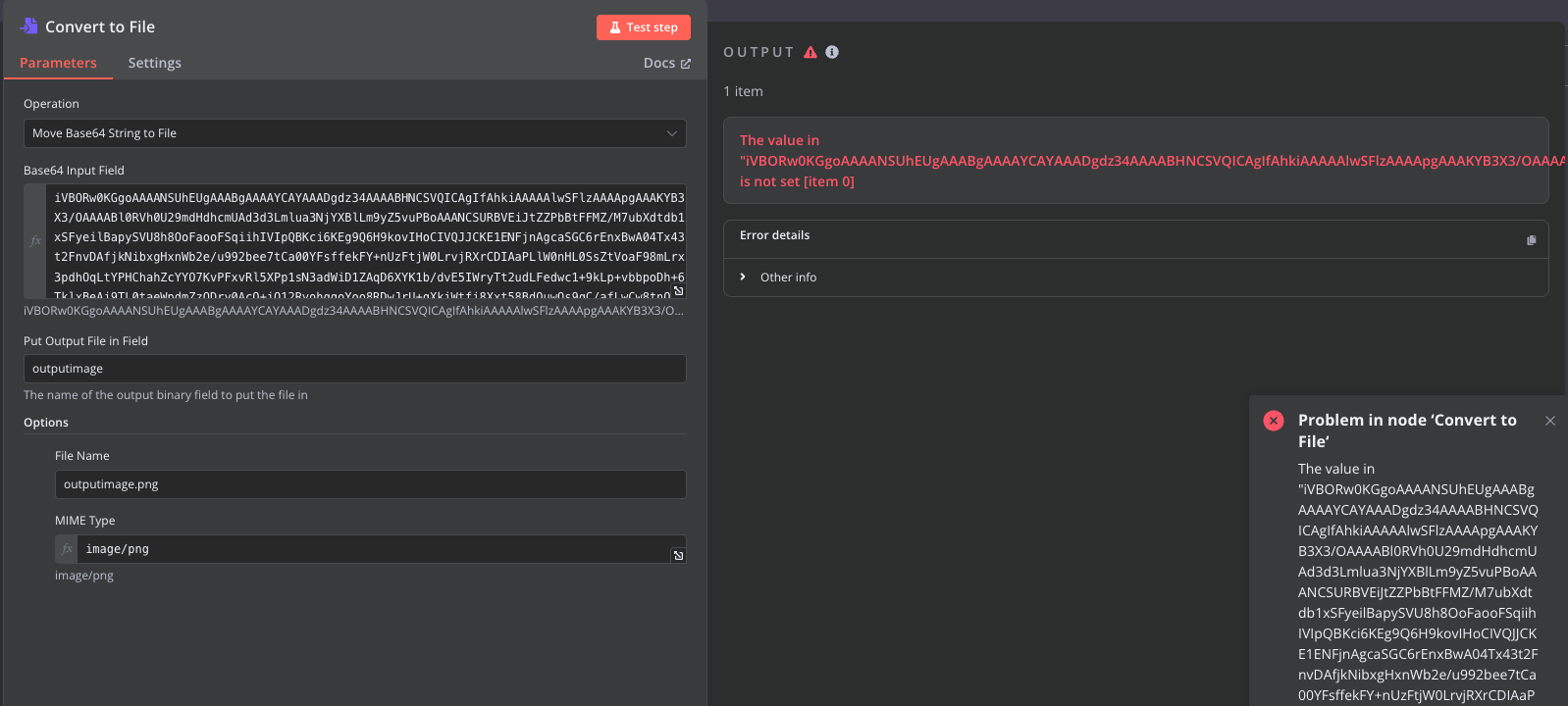

Sorry forgot to mention, i’m on 1.91.3 self-hosted.
After much try and error, i found out that the generated Base64 String wasn’t valid Base64.
I recreated the HTTP request via cURL from Stable Diffusion from scratch and now it’s working.
