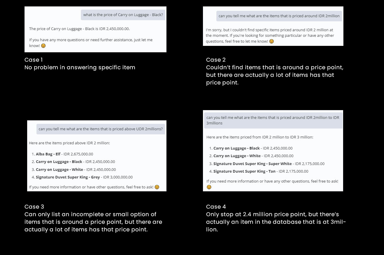

How do you get the AI read all the data and actually give a whole and complete answer list accordingly to the database?
It seems like the chatbot I’ve created is not able to give a whole and complete data when asked to list items that has a certain price point.
For context, the original database is from google sheet that has been inserted to supabase, with only 1 column for object, and one column for price, with total of 2059 rows. So I don’t know if this is a limitation from the platform (either n8n or supabase) or my prompt, or the openAI.
I have attached couple of cases that you guys can take a look as well on what I meant and the workflow

Abang, I think the main problem may be from not using the optimal toolset for achieving what you want.
If you have a database with products and prices, putting them in a vector-db and querying with AI only will not output exact results as you already see for yourself.
Keep in mind that:
  • Vector Databases Are Designed for Similarity, Not Exact Matching
  • Product Prices Require Precision, Not Approximation
I recommend adding a SQL-tool for querying your product data, as this will give much better results (eg mySQL).
A relational database (SQL, PostgreSQL, MySQL) is better suited for storing structured product data where exact lookups are needed.
Let me know if you need support in this :slight_smile:
