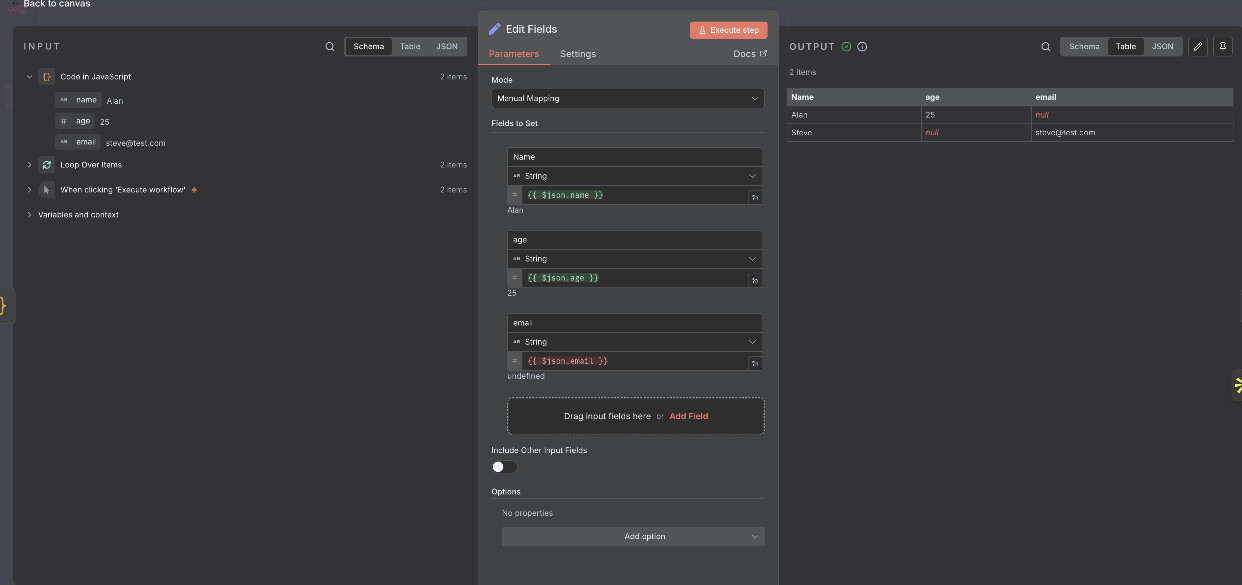

Hey @Jasperfrost Your Postgres node is seeing all upstream data (including the webhook) — normal n8n behavior. Fix is either: (1) set the node to only use input from the connected node, or (2) add a Set node after your Code node with just the fields you want. Postgres will then ignore the rest. Share a screenshot of your Code → Postgres setup and I can point out exactly where to change it.
In the Postgres node, only map the columns you actually want to update (like name, age, email). That way the extra webhook data won’t sneak in.
#2 is still valid too — drop a Set node after your Code node so only the cleaned fields move forward.
Here’s a quick mock-up of the payload you’d want Postgres to see (below ), based on your example
