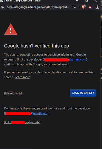

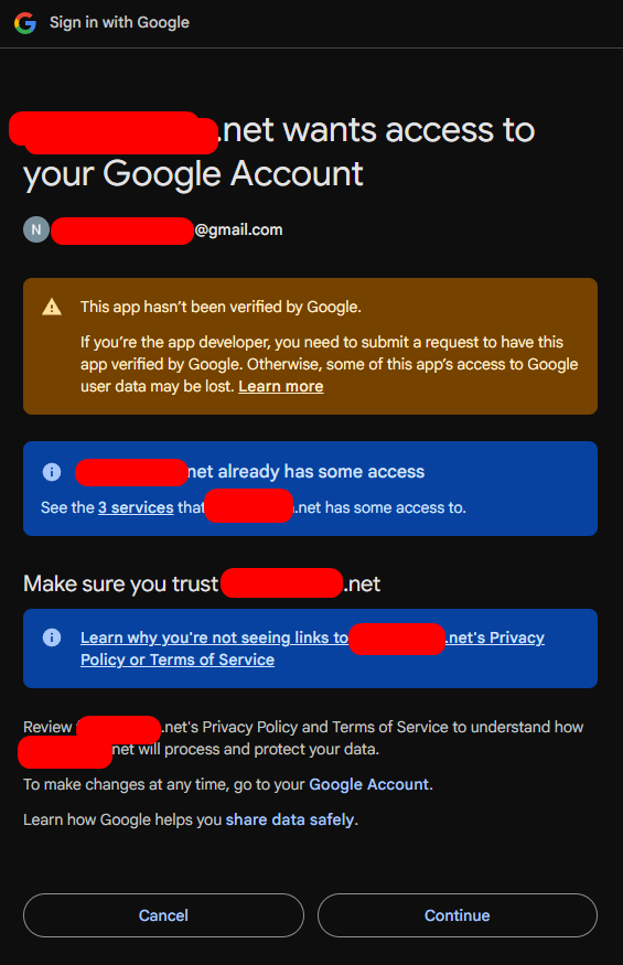

These are the login popups that I get from google when I login from n8n (not sure if could be useful):

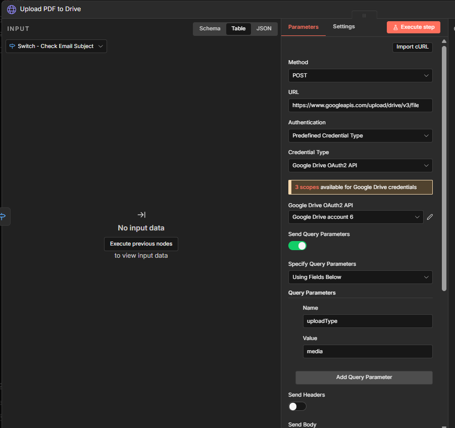

The error I am getting is this:
Problem in node ‘Upload PDF to Drive2‘
The connection was aborted, perhaps the server is offline

Have created a new project now, and in meantime I have been testing another workflow and have noticed that seems this situation is only happening with this step:
Can you please let me know if it was just for one particular steps or if it was for all cases related with google drive steps?
@marafado88 please consider using inbuilt Drive node it is far easier to setup and easy to debug in all cases , i would not say it is related to particularly that issue but sometimes things just does not work with console so creating a new project make things work again , not related to n8n but it is something off from Google console. Please again use Drive node for interacting with Google drive services:
After switching that with the Upload File from Google Drive, the builtin one, it worked. I was using that because it came with a template that I’ve used, but since it was the first step using google drive, I thought that there was something more related. So after switching those that I had before with Google Drive builtin one, it worked with the other credentials that I was using already! Thank you!
