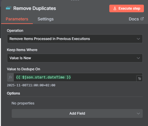

Actually, there’s a very simple way to do this without logging anything, if your goal is just to monitor changes in the start time.
Your secret weapon here is the Remove Duplicates node,
and make sure to specify the event name:
to make sure we’re removing the duplicated time of the same event not other one.
I tested this approach with this workflow:
give it a try and let me know if it works for your use case!

Sorry to bother again! It works but I am still wondering why we use operation “Remove Items Repeated Within Current Input” here, rather than “in previous executions”. From my understanding of the n8n docs, “within current input” operation is checking into the input itself if there is any duplicates? How come it works to compare the updated input with the old one?
Thanks! But what confuses me is that in a single execution (within current input), you have only one output from previous nodes, how are you going to compare if there are items with duplicated ID but different startTime?
Hmm, wait, you’re correct, @DonLBerlin
Actually I was wrong, I just noticed that it only works because the if node isn’t passing the {{ $json.start.dateTime }} when the update is not for the start time,

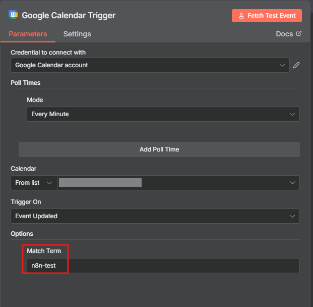

We should really use the “In Previous Execution” option and edit the trigger’s “Match Term” to specify only one unique event,
This means we only watch one event update and remove duplicates of the start.dateTime, I think this is it.
Hey Anan, thanks again for the help!
I used “previous executions” node and “keep items where value is a data later than”, with “value to dedupe on” set as “updated“ fetched from trigger, so the last updated info is always the source of truth. I have exprimented it several times and now it is working perfectly!
