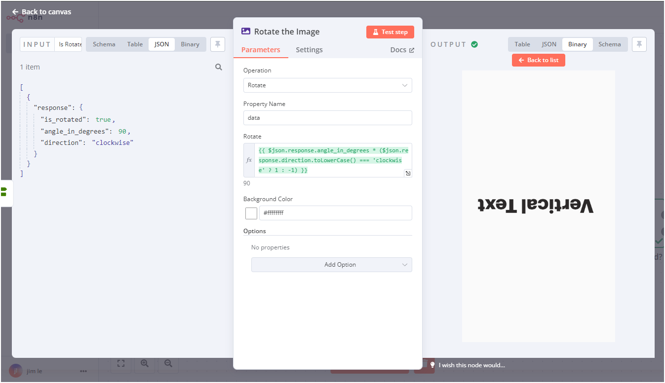

I created a quick test below which is able to identify if the image is “rotated” but is unable to correctly provide the params to rotate it. I would imagine specialised AI vision models to do a lot better than Multimodal but I haven’t experimented enough to say for certain.
Yes it does work !
I think I’ve mixed up a bit the versions I was working on, but in the prompt if you stipulate that it has to be easily human readeable horizontally, it takes it ! :slight_smile:
