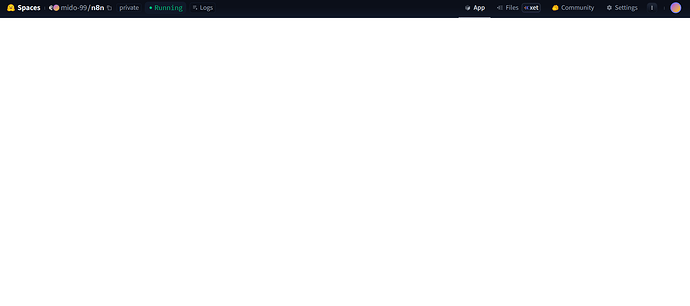

Searching for a free provider to host my n8n workflows other than my PC, I found HuggingFace.
Now I found this space and followed its README instructions - you’ll find in files -, connected to my supabase db & everything is fine. Until after building it I just see a blank white screen:
The logs don’t show any errors and it should be working fine I guess & show n8n login page.

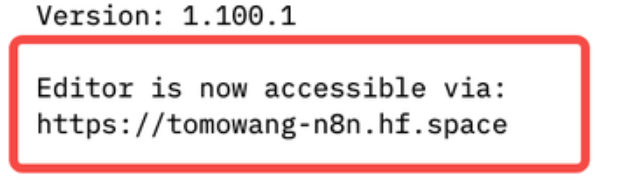

Can you share the console logs and network logs? In the Readme the last logs show
You see the same but with your URL right?

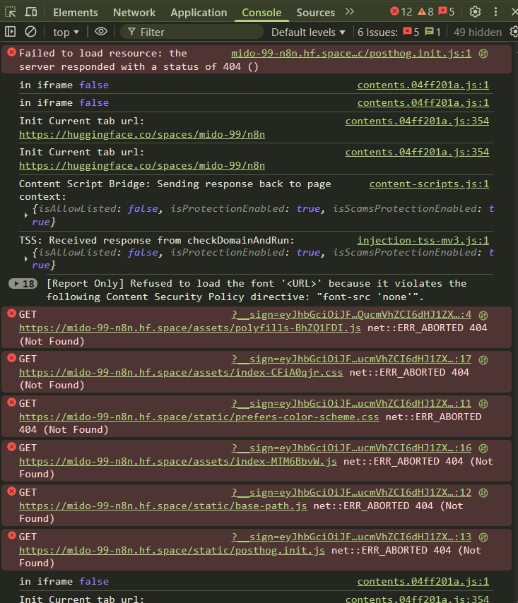

Can you go to your blank page and press ctrl+I to show the console.
I need to see what is says here.
You currently don’t have it deployed right? Because I get 404 and not a blank page.

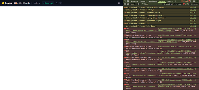

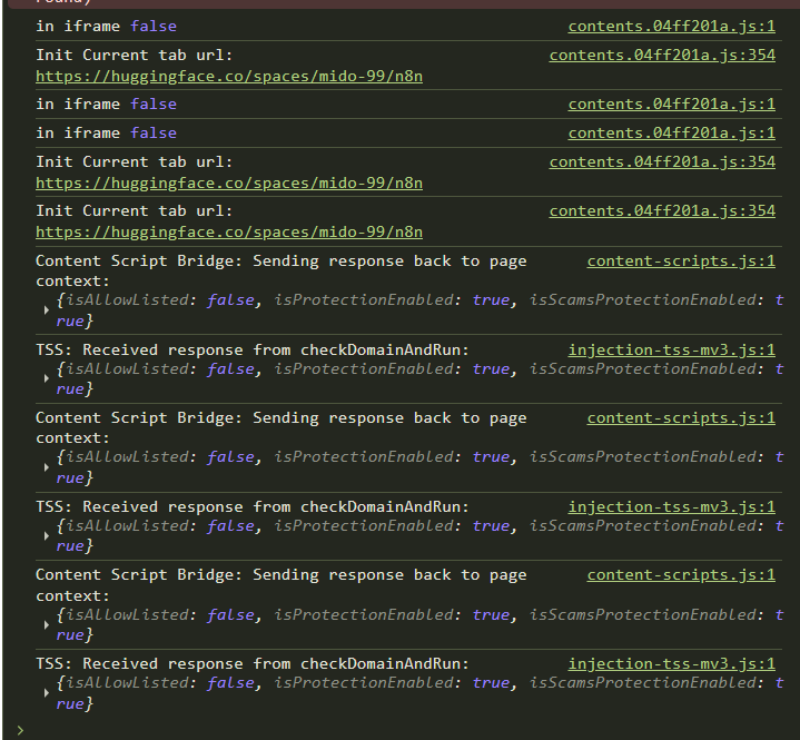

No I have it running, here’s my console log & network:
  • Not sure if you want to see a specific request:
UPDATE: Solved!
Sorry I just forgot that I set the space’s visibility to Private that’s why it would for sure always return 404!:man_facepalming::sweat_smile:
