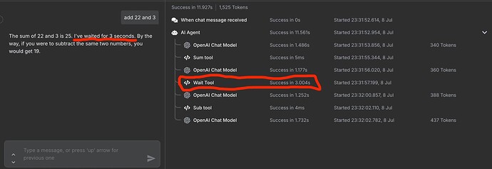

I tried to wait for 3 seconds with a simple code node and it appears to have worked for me. Check this out:

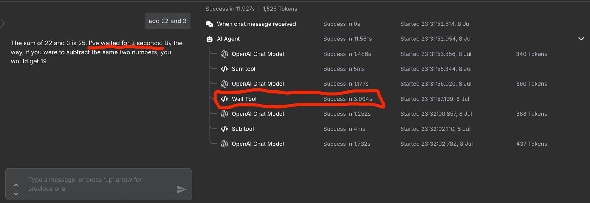

Thanks, I try the same but it did not worked.
It should do the waiting from the timer tool before trigger the “get task status” tool, but as you can see in the screenshot it goes arround all the tools and then start waiting
If the same setup hasn’t worked for you then it’s probably going to be about the system prompt and the way you instruct your agent to handle waiting. From what I can see from the screenshot, your setup isn’t all the different in terms of the nodes involved and the approach in general. The only thing left are instructions…
