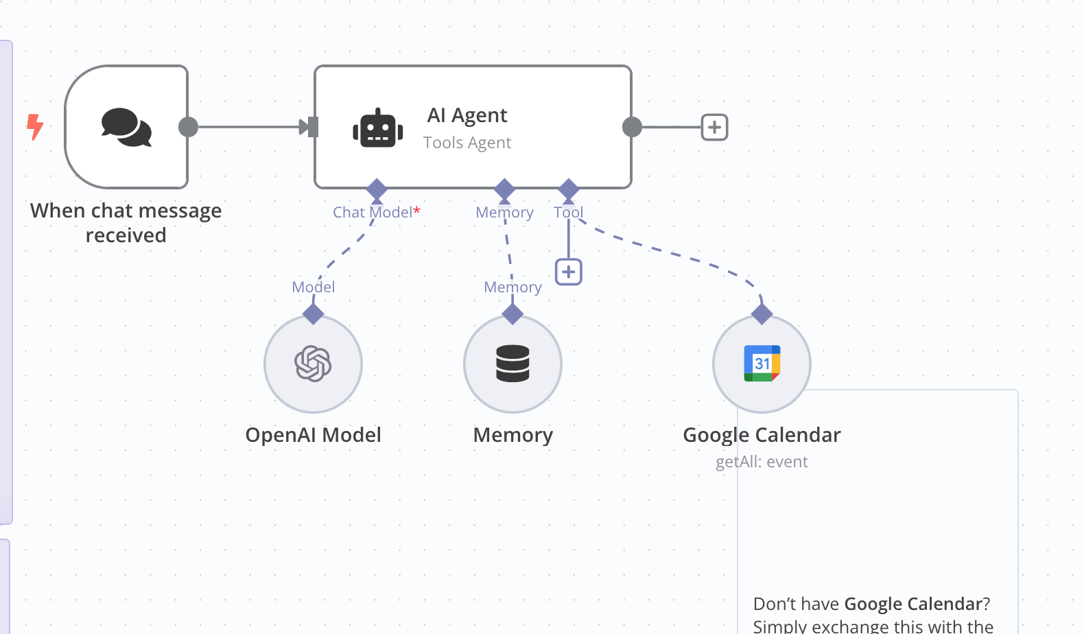

just start testing the out of the box agent demo to book an appointment but is not working… reach the max iterations and hangs…
That’s because the only tool connected to the agent is to get all events.
There’s no tool for the AI to actually book the appointment.
