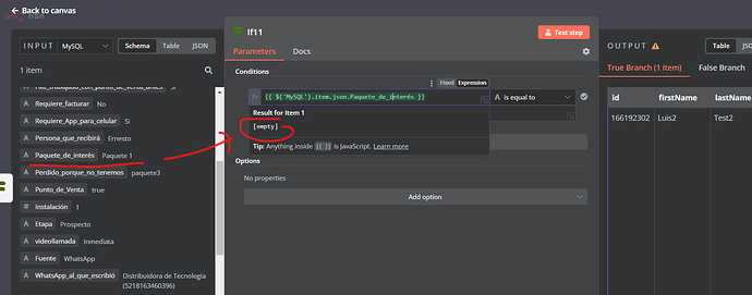

Hello I have a problem with the “if” module, it was working correctly but after clicking on “Test step” in one of my 34 “if” modules, when I wanted to retest the workflow I can notice that in the conditions the values are always as “[empy]” even though the value exists.
I tried changing webhook to production, generating another webhook but it remains the same.
I don’t know if something similar has happened to you with the “if” module and how you solved it.

The UI may be not accurate in determining what to output. Try to refer to the IF node instead of the SQL node.
Another option is to use <nodname>.last().json instead of <nodname>.item.json
Thanks, after reviewing more in detail I see that it is a visual bug in the “if” module, the conditions work fine, it is only that detail that visually says empy.
I also tried with the .last().json instead of .item but the same thing happens after executing the whole scenario when I check it says [empty].
