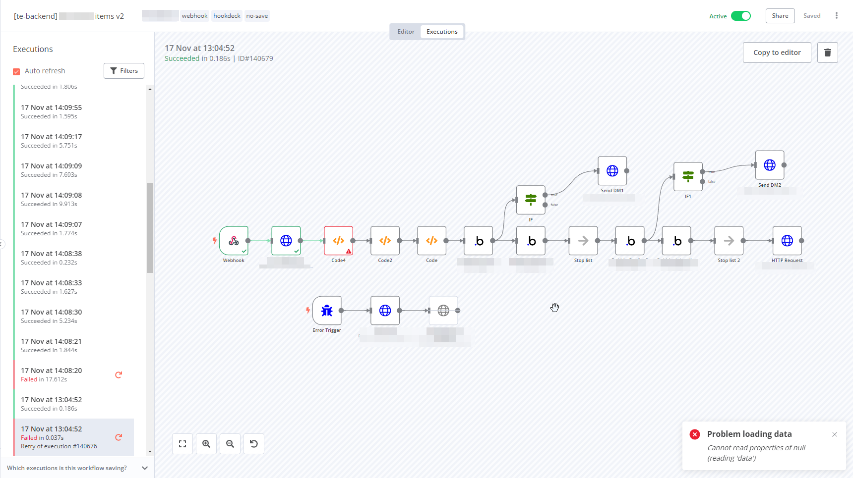

Again it happened a second time editing a workflow, this time hopefully I had saved the progress. It went to a failed execution:
console.log error:
Any ideas? Should I try deleting these failed workflows? Delete them all? Maybe a failed workflow is stuck or smth?
Deleted all failed executions… let’s see if still happens…
It’s still happening, even after deleting the failed executions I still see them If I navigate to executions… but when I click on them “Cannot read properties of null (reading ‘data’)”
