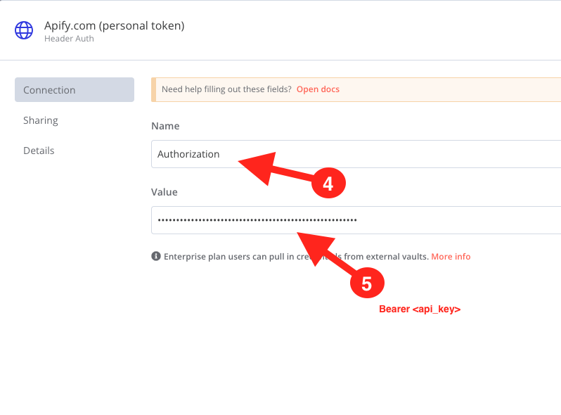

I actually finally figured it out and embarassingly this issue has hit me before, I forgot to add "Bearer " before the Apify token when setting credentials in the workflow. So it all ran, just gave 401 errors in the web searches. Basically my “Deep Research” was just hallucinated and internal knowledge junk. I got it fixed now and the results are fantastic.
Thank you, @JaySmith502, for pointing me into the right direction. I’ve added "Bearer " before the token and changed the “Name” to “Authorization”. That has solved my authorization problems with Apify.

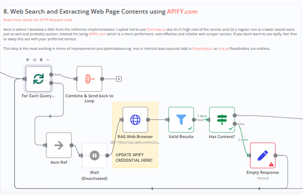

First, thank you for the time you spent to create such a work. I have a mini problem going on when i am testing the subworkflow, below. I tried adding Wait node but did not work out.
Referenced node is unexecuted
An expression references the node ‘Item Ref’, but it hasn’t been executed yet. Either change the expression, or re-wire your workflow to make sure that node executes first.

Hi Jim! Thanks for this awesome workflow. Just a question, I noticed that in the Set Next Queries, follow up questions is showing as undefined and I can’t seem to where this is being called.
Hey @Wojtek_T From some of the similar reports I’m getting, it’s likely that your Apify credential is misconfigured and therefore no sources are showing.
Try this and let me know if this helps.

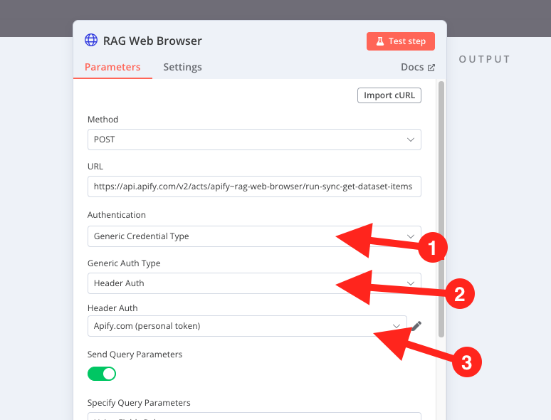

  1. Create a generic credential
  2. Set it to “Header Auth”
  3. Click on “create new credential” option in the dropdown under “Header Auth”
  4. In the new credential modal under “Name” field, enter “Authorization”
  5. Under Value, you first need to enter "Bearer " before your API key. eg. “Bearer API_123456…”
