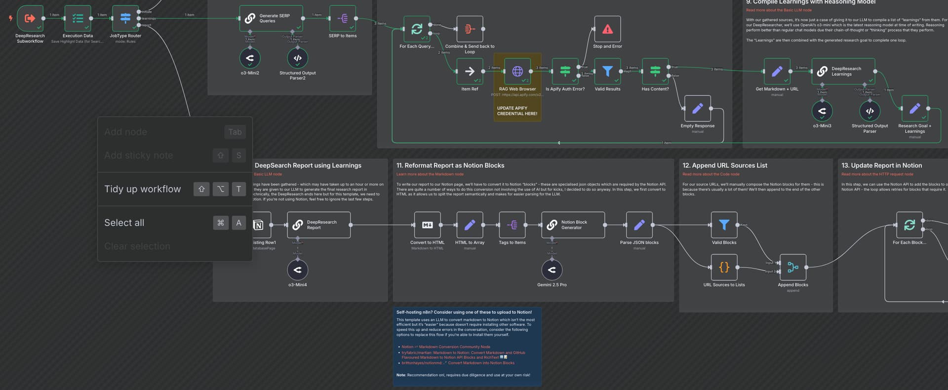

This is awesome! I was able to get everything to work perfect except the form is missing the depth/breadth sliders. Could that be a browser issue on my side?

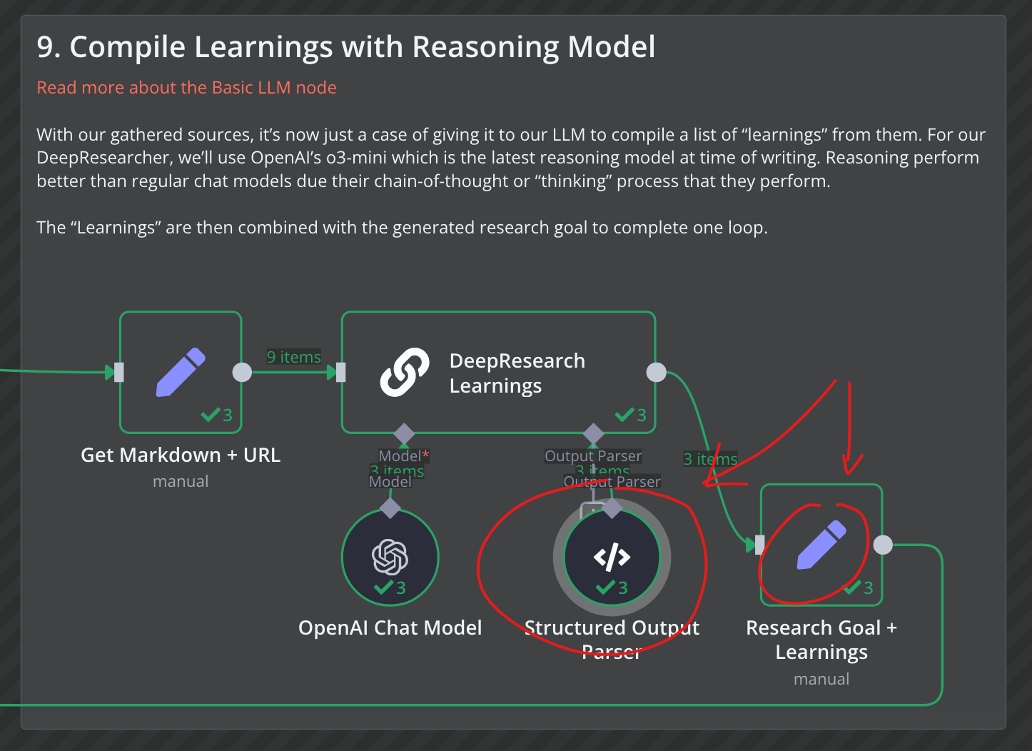

Hey @sebru1 Welcome to the community.
From what I can see from your screenshot, I can see 3 items entering the “DeepResearch Learnings” AI node but only one item coming out - which my guess would be that this is where the loop is failing and not completing. In normal n8n behaviour, when a node doesn’t output anything the flow will stop.
I also see you’re using OpenRouter so I leaning towards whatever model you’re using is probably just not able to keep up and is deciding to quit midway (sorry for the simplification!). Of course, I could be dead wrong as well - but next steps would be definitely taking a look at the model outputs.
Unfortunately, I’m not providing general support for this template due to it being intended for advanced users to discuss workflow building techniques. I can wholeheartedly recommend commercially-backed DeepResearch products like Perplexity, Google and Jina etc instead which perform much better!

Do you have an idea, why the Sliders from the question creation don’t work?
I love the look, but I only can see the text Field and n8n is dying after starting the flow, when I change the fields to Tex fields, it works.
Yeah unfortunately, n8n forms don’t support sliders and I hacked it a few times to make them work. The current hack was patched recently in an n8n update which broke the form again.
I will eventually get around to updating the template but in the meantime, convert them to text fields and you should be ok.
Also should probably take this opportunity to clear up a common misunderstanding, the workflow also works without the forms! The forms are just a nice to have - feel free to get rid of them if you don’t really need them.
