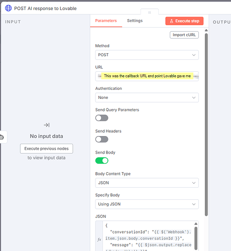

Below were the changes I had to implent on n8n to make the above solution work:
  • Instead of the typical webhook in –> AI Agent/ whatever back-end processing work –> Response to Webhook node, you need to immediately provide a ‘Respond to Webhook’ response back to the source (in my case, Lovable), and separately send another POST request whenever your processing is done (see mine comes out of the AI agent)
This is what the ‘Respond to Webhook’ configuration looks like:
Here’s the JSON
“status”: “Processing”,
“conversationId”: “{{ $json.body.conversationId }}” ,
“message”: “Your request is being processed. You’ll receive a response shortly.”
As for the ‘POST AI Response to Lovable’, that’s just a HTTP request node:
JSON body I used:
“conversationId”: “{{ $(‘Webhook’).item.json.body.conversationId }}”,
“message”: “{{ $json.output.replace(/\n/g, ‘\n’) }}”
Hope this helps?
