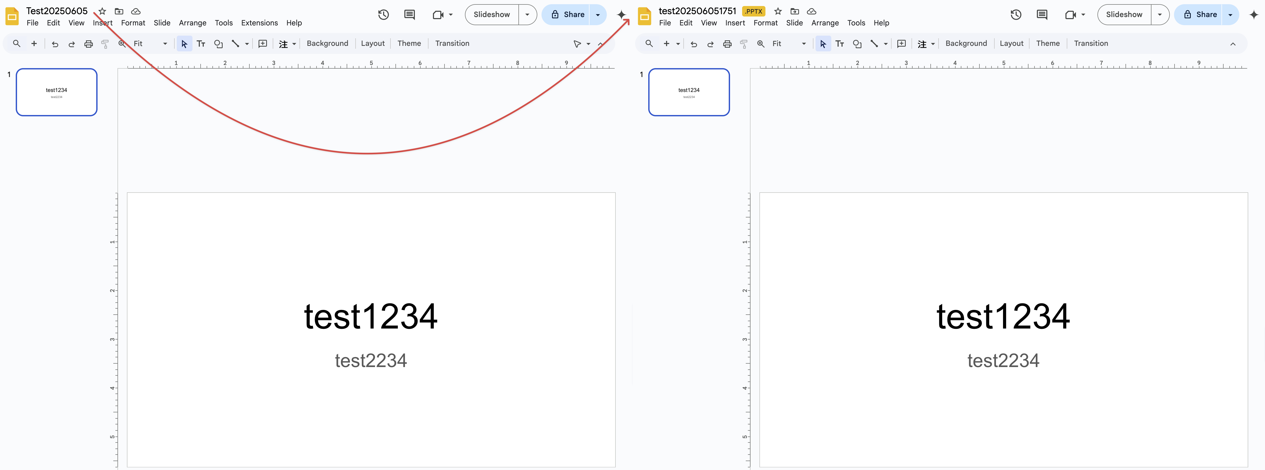

(no Python or code needed)
I test a solution likes:
  1. Create a slide in Google
  2. Extract to binary
  3. Convert back to .pptxt
Ane the simple scenario seems work
