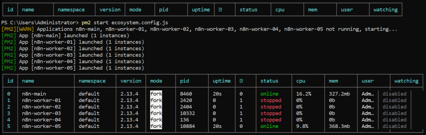

This was our initail configuration. But this starts only 1 worker.
All remaining workers stops with below message which is the actual issue posted
info n8n Task Broker’s port 5679 is already in use. Do you have another instance of n8n running already? { “file”: “task-broker-server.js” }

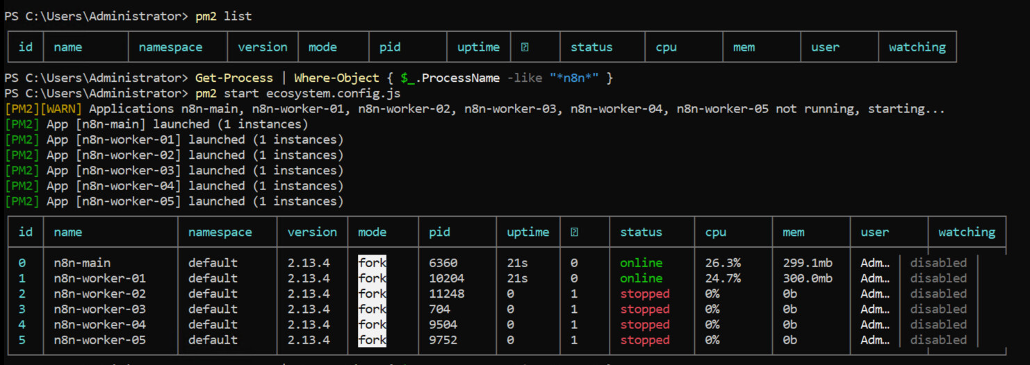

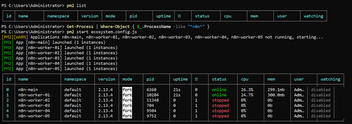

Are you sure you’re not running more than 1 N8N Main instance? Please share output of
ps -ef | grep n8n
10824 node --disallow-code-generation-from-strings --disable-proto=delete C:\Users\Administrator\AppData\Roaming\npm\node_modules\n8n\node_modules@n8n\task-runner\dist\start.js

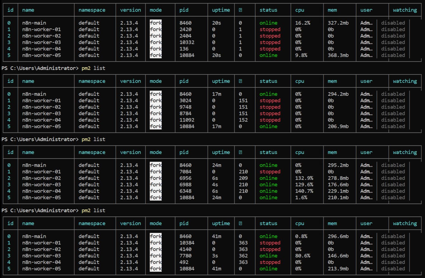

run ‘pm2 stop all’ or ‘pm2 delete n8n’ and try starting main again. Let me know the outcome.
1 Main and 1 Worker instances which came Online on the 1st attempt remains same. Other Worker instances are getting re-started, turned Online but again back to Stopped.
