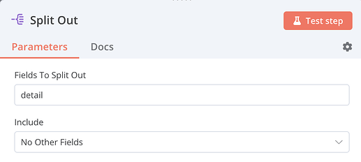

@reve , to split out the details in the webhook, use the field detail instead of detail[0].operatorid, detail[0].moduleName.
thank you!!
