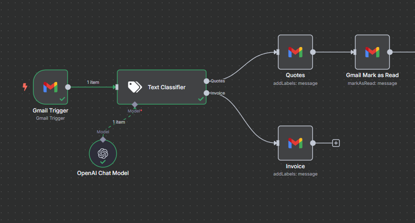

I am experiencing something similar, my workflow broke after upgrading to the lates stable version of n8n. Funny enough I can execute the workflow but it only does the 1st 2 nodes then stops and says “workflow executed Successfully”. I am running the Cloud version of n8n. Any ideas on how to fix this? Much appreciated.
I’m afraid I’ve never run into that particular problem before.
