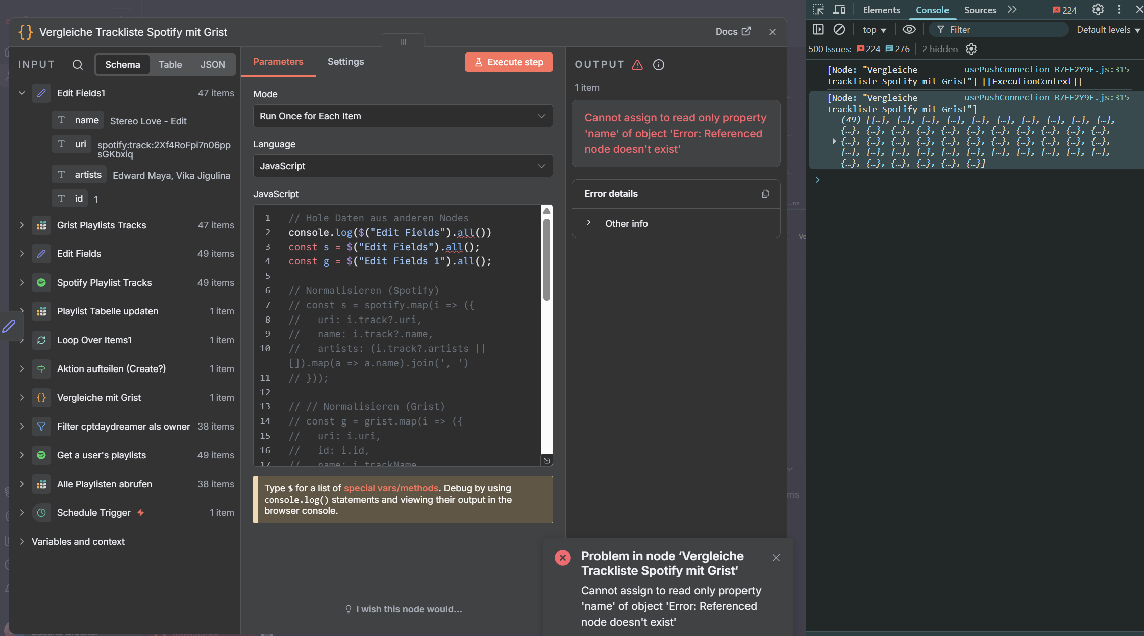

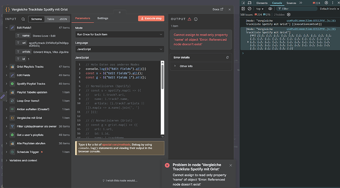

Version 1.117.3 Selfhosted. I didn’t get the solution here for the problem and what is helping: Cannot assign to read only property 'name' of object 'Error: Referenced node is unexecuted'
@Jim_Le I don’t have a loop, only an if node. Is it the same problem?
I don’t get why I can log it without problems but not use it in a variable or anything else then.
