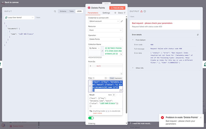

I can delete points in Collection using filter:
{“must”: [{“key”: “metadata.name”,“match”: {“value”: “{{ $json.documents[0].name }}”}}

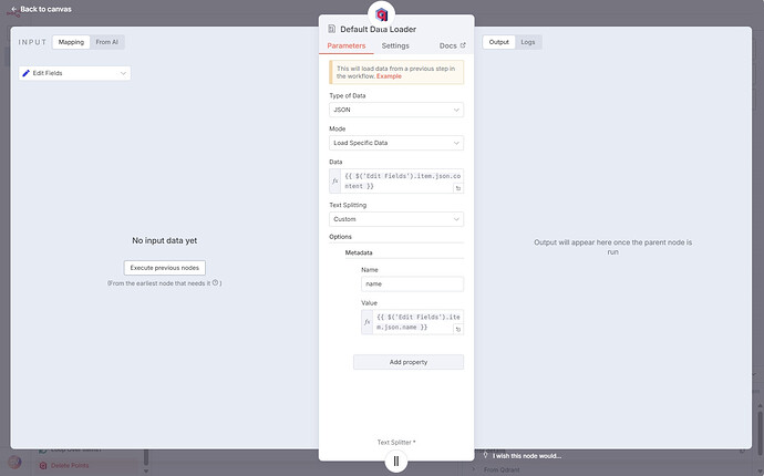

I using Qdrant vector db with dataloader: metadata.name
{ “status”: { “error”: “Bad request: Index required but not found for \“metadata.name\” of one of the following types: [keyword]. Help: Create an index for this key or use a different filter.” }, “time”: 0.000019217 }

Yeah, the issue was about the metadata, i must create payload index for metadata.name before using it for filter or anything
Indeed the configurations of the metadata and the payload index was causing the issue, have you solved it?
Yes, i solved that. Create a payload index metadata.name type keyword after you create a collection.
