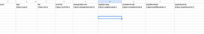

  1. In my workflow, I have an AI agent outputting 10 different content ideas. I have a split node with an upstream Google Sheet node and this is my problem:
My split node output is this:
When I try to map my Google Sheet columns manually, the output is simply what I have mapped instead of the actual columns:
What I want to achieve is for every result, in this case (0, 1) to have a separate row in Google Sheets for every output. I have the columns in the sheet, but when I map, I don’t get the actual values:

Your suggestion works, results are appended to the sheet in separate rows. Just for the community here, if you want the output to be dynamic, you can flatten the array and it all works!
