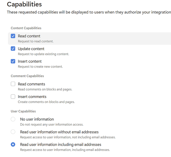

Does your integration have the required permissions:
Can you see your Database from list ?
